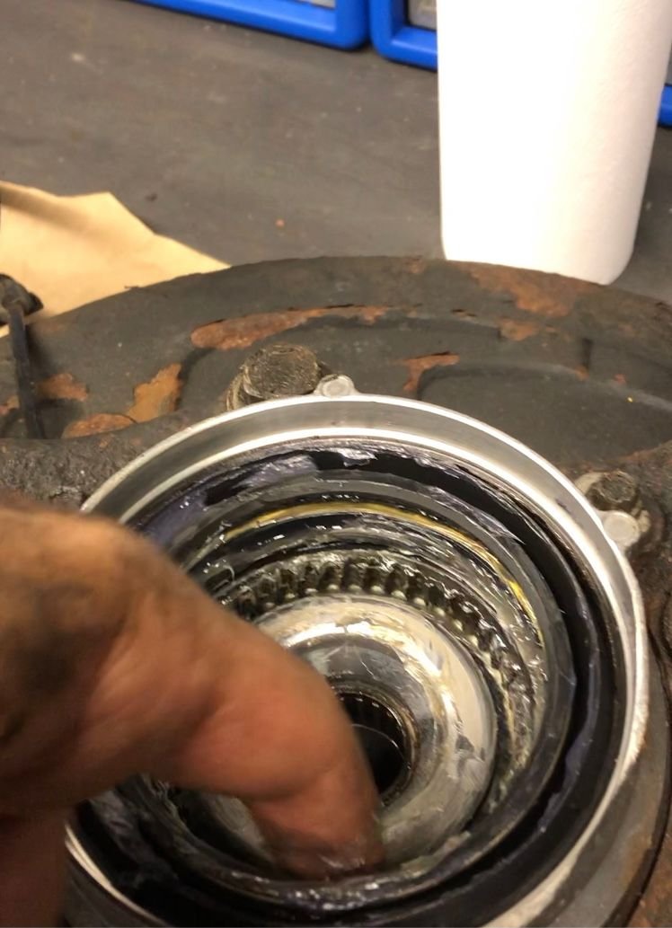

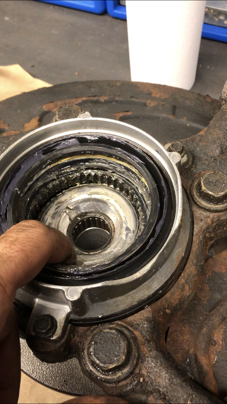

Is this ring supposed to be loose like this when vacuum is applied. My first time installing one.

Video won’t upload. There is a black ring with teeth that can be moved around inside the actuator when vacuum is applied. The teeth are completely clear and not meshed with the rest of the unit.

I understand how the system works. I want to know if that black ring should be able to come completely free so that it can be moved around and no longer meshed with anything. When I let off the vacuum, the iwe sprang back and that ring didn’t mesh back in every time. Sometimes it would get stuck and keep the iwe from engaging.

It turns out that the new aftermarket iwe isn’t broken. After installing the new iwe, hub and cv shaft, I was still hearing a clicking/light grinding noise. I spoke to a mechanic about it and he said there are some aftermarket iwe’s that are junk and he won’t use them because they cause problems and they don’t last.
So, I went to the Ford dealer and bought an iwe and I took the aftermarket iwe off. I had the two of them on my workbench and the Ford iwe took much less effort to compress. I tested both with the vacuum tester and the Ford iwe was fully activated at 5 inHg and the aftermarket took 12 inHg. I installed the Ford iwe and went for a little test drive. All ok. It would seem that the aftermarket iwe took more vacuum than the truck could supply to activate it.
