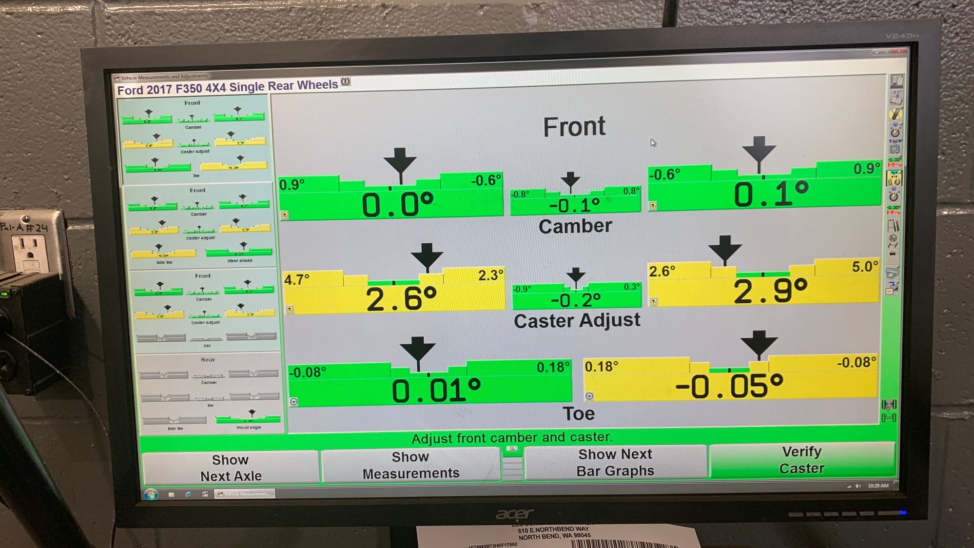

Originally Posted by V10DoubleTow
Carli shims are 2°. SPC, Delco, and others are available in 2.3° and 2.6°. Run 2.3° on the driver's side and 2.6° on the passenger side to compensate for road crown.
SPC Caster Adjusters:
23268 Cam +.50 / Cas +2.3
23269 Cam +.30 / Cas +2.6
so what should the castor angles be from factory and post shims?
these are my measurements post 1.5in level, no track bar(yet). Have longer shocks installed and a new steering
Heavy suspension 2.8 on the left 3.1 on the right
Standard suspension 3.5 and 3.8
Not entirely sure what they should come from the factory with, but with 1.5" level you likely lost 1-1.5 degrees of castor. I would want to be in the 4-6 degree range post level/lift for optimal results.
