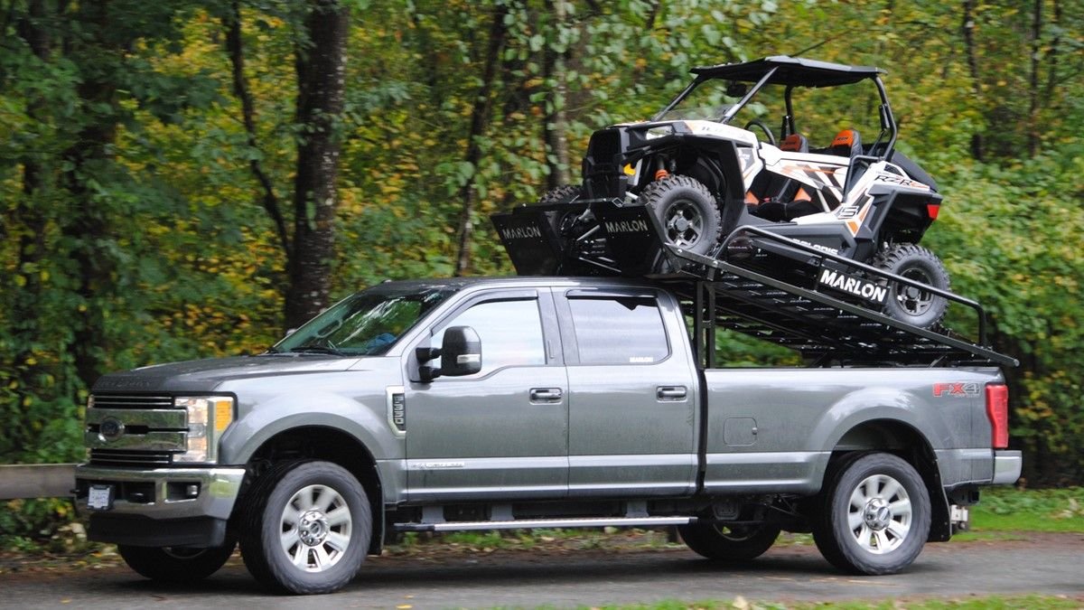

Since you asked for the BEST level kit, I thought I’d throw this out there. It’s pretty expensive but lowering the rear is a whole lot more fun than raising the front!
