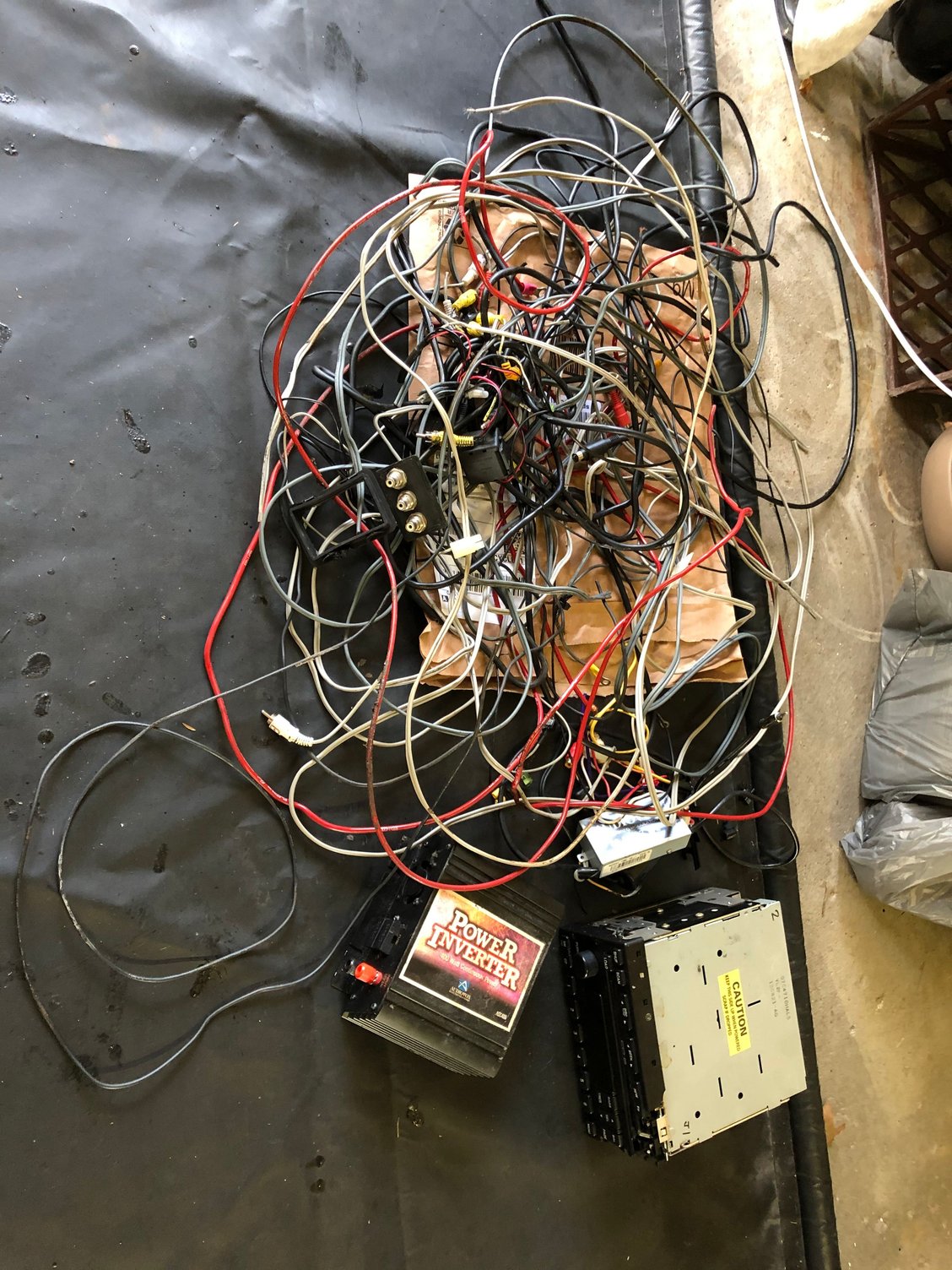

As for previous owner electronics, I’m not sure what all they had going on, but I assume an aftermarket dvd/sound setup. I spent the better part of a day removing all non oem wiring prior to installing an Android headunit. Picture of that mess of wiring/ hardware attached.
