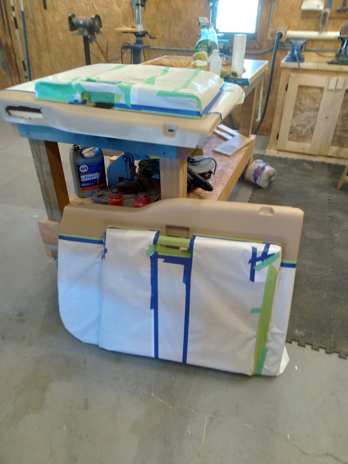

On my 2013 SD my door panels where badly sun faded, I cleaned them with alcohol and painted them with base coat and matted finish clear coat. I changed color because I couldn't match the rest of the door panel.
Denny
What name brand paint did you use ? Your door panels look beautiful. I will probably be repainting both door panels, the dash, and rear suicide door panels. Very dried out and ugly fro sun damage. Thanks !!!!

A friend of mine has a body shop, he mixed it and I took it home ans shot it but any name brand would work. The most important thing is to get it clean, my 03 F150 is also needing the door panels done but I want to match the color on them.
Denny

The fade is from the sun also know as UF damage. I went with automotive paint because of the protection it gives from the sun and it's more durable than the dye.
Denny
