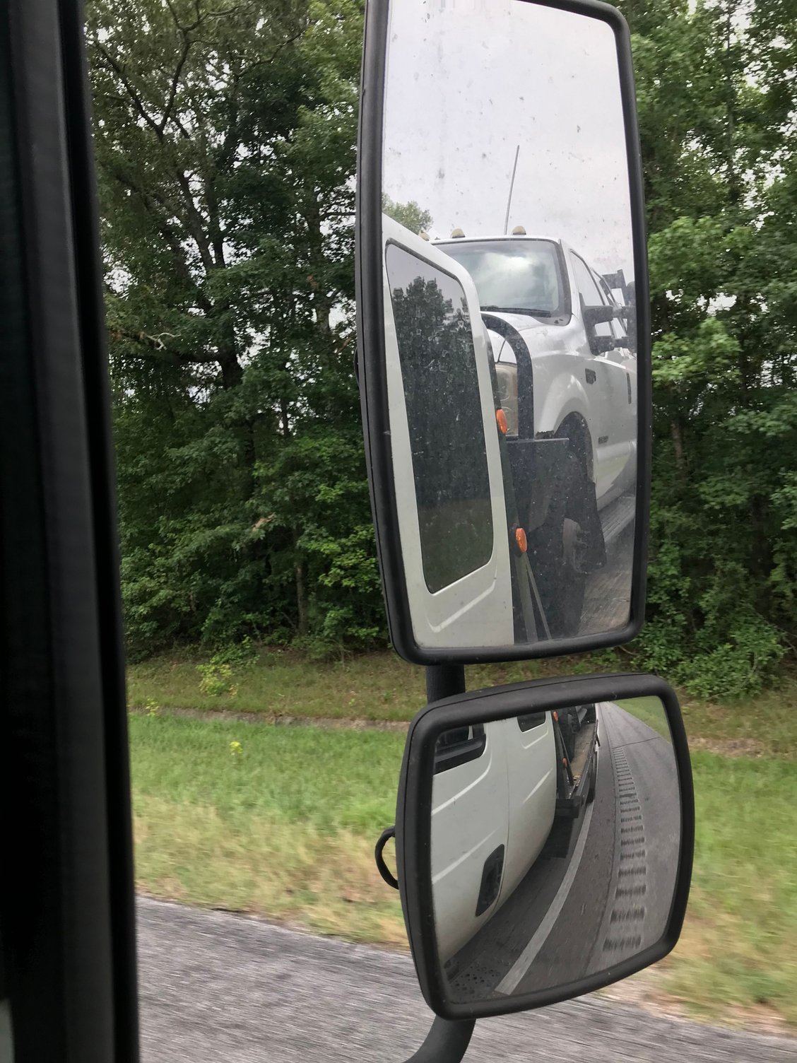

Does this kind of towing count??
Lol. It’s always an adventure!! GFML.
Btw, the dogs are riding comfortably in my truck with COLD AC blowing on them and I was suffering and sweating my *** off in the tow truck. Could not complain because that poor driver does this every day in that miserable Alabama heat.......
Absolutely it does and absolutely GFML!

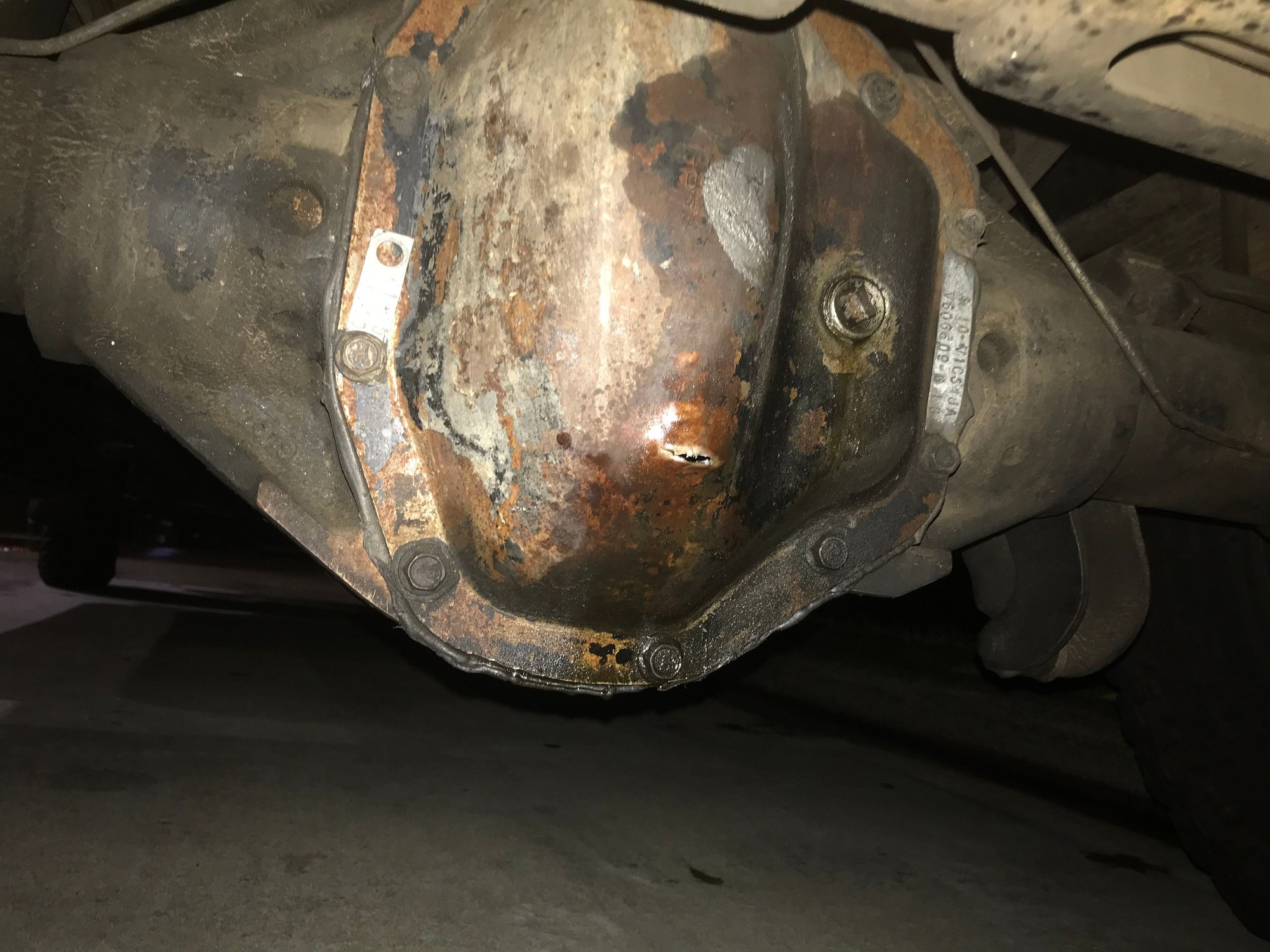

Originally Posted by ToolmakerRob
Jason-What happened/reason for the rolloff/flat deck?
Rob
There was a loud bang and a louder grinding/terrible noise during a 50mph curve/on-ramp and then this evidence that parts of the rear differential were willing to try anything to escape the confines of their cozy home. I guess after 467k miles, they were anxious to relocate. When the other refugees are located, they will be treated poorly as a deterrent to future escape attempts from this housing.
You can see evidence of oil overflowing the fill plug hole when I checked it before this trip.... The gray shmear to the left of fill plug is where I wiped the grime off the magnet the last time I checked/added fluid a few weeks ago before a trip.
