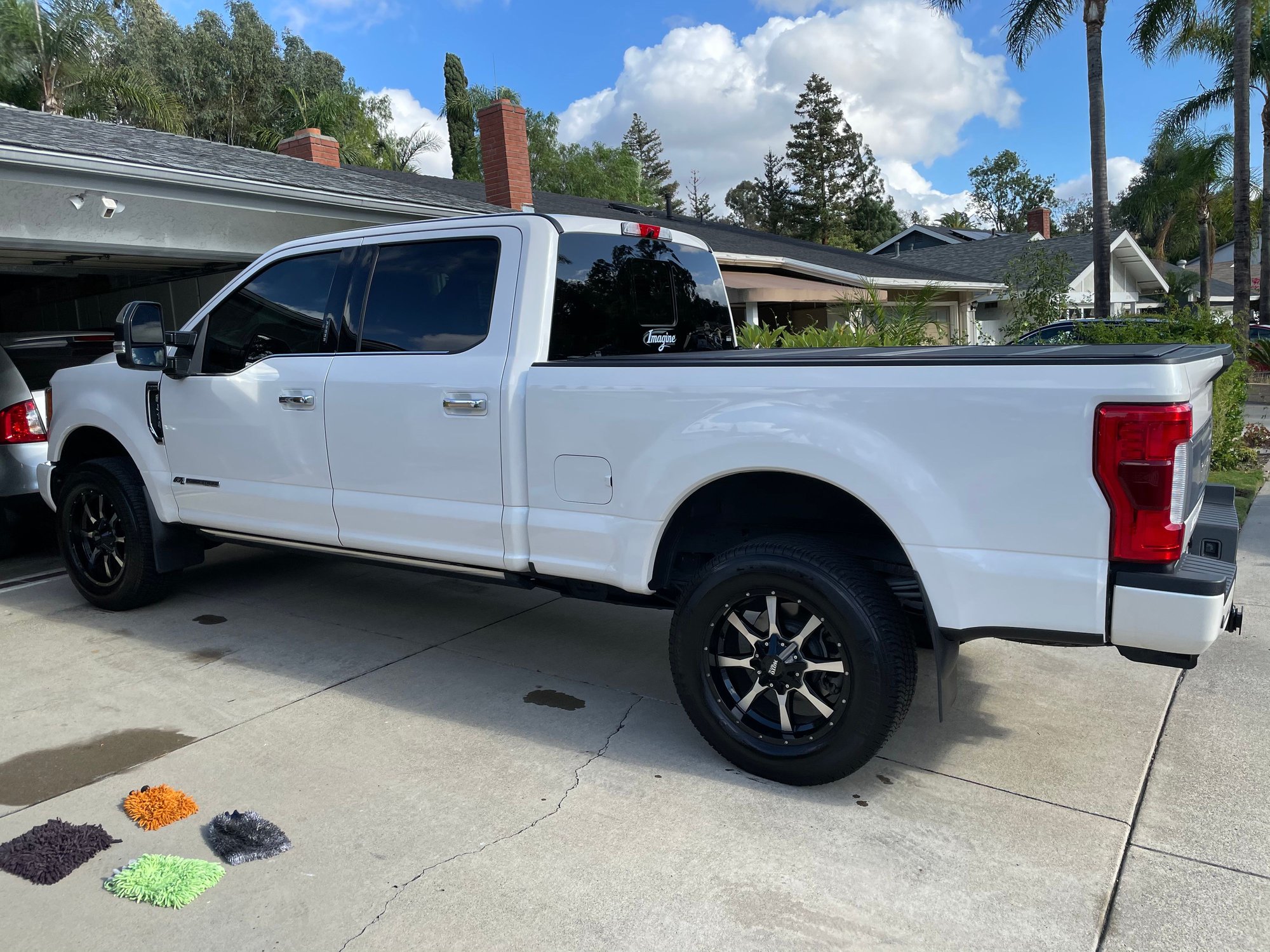

2019 F250 6.7. Seems like the hubs aren’t engaging in auto mode. I switch to 4h or 4l and the dash shows everything is being done but had to manually lock the hubs to back a trailer up in grass and today had to do it again in snow in California of all places. Truck would slide but with hubs in lock it was a beast.
might be a vacuum line issue but not sure where to look. Still under warranty but last time the truck was at Ford fleet service it was there for 2 weeks so maybe something I can fix or check at least.
Sure glad I remembered to bring an Allen wrench for the wheel cap.

Thanks for the tips. I switched to 4h after a chain stop and drove for 20 minutes or so until we stopped for a minute and couldn’t move before going outside to manually lock them
So plenty of time to engage.
Washed it today and put the caps back on but gave the hubs a few spins before. After going back and forth from lock and auto about 4 times air started bubbling out where it says Ford. Tried 4h in the driveway and could tell a difference with steering vs 2h so maybe they were plugged up?
Guess I’ll wait and see for now. My little helper is always down for a challenge.
