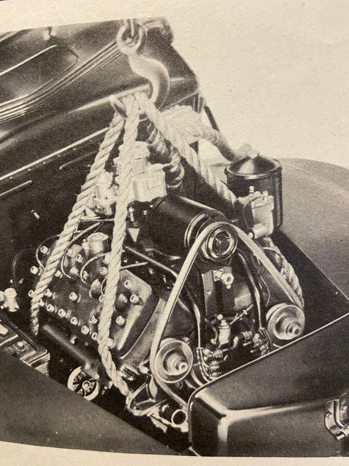

Hey all. I'm pulling my flathead V8 from my 45 Ford in order to do some welding where the steering gear connects to the frame. I haven't pulled the motor since I was a kid. Any advice on where to or NOT to connect the chains to pull the motor. I was going to just pull off some of the head nuts and connect the chain diagonally in order to balance the engine. Any tips to avoid troubles would be appreciated. I'll post some fun pics. too

Here is how the '45 ford Truck operators Manual shows to do it.
https://www.jalopyjournal.com/forum/...ifting.241146/

Roger that
