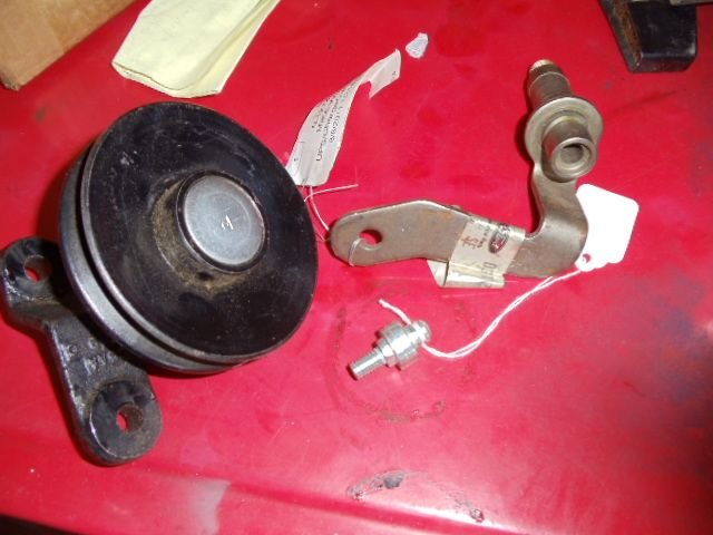

I know exactly what you're talking about. That's a very common problem with these trucks. The correct repair is to replace the stud and transmission arm. The last time I searched, there weren't any arms to be found and the supply of studs were getting low.
Assuming C6 2WD: Lever assy D3TZ-7A256-C, Stud D3TZ-7B415-A.
Using Rear Counter parts locator I did a search and found two obsolete dealers that each show one of the studs, no one shows having the shift arm
https://www.rearcounter.com/D3TZ-7B4...arts66075.html
Worn shift arm
Worn stud
New arm and stud
