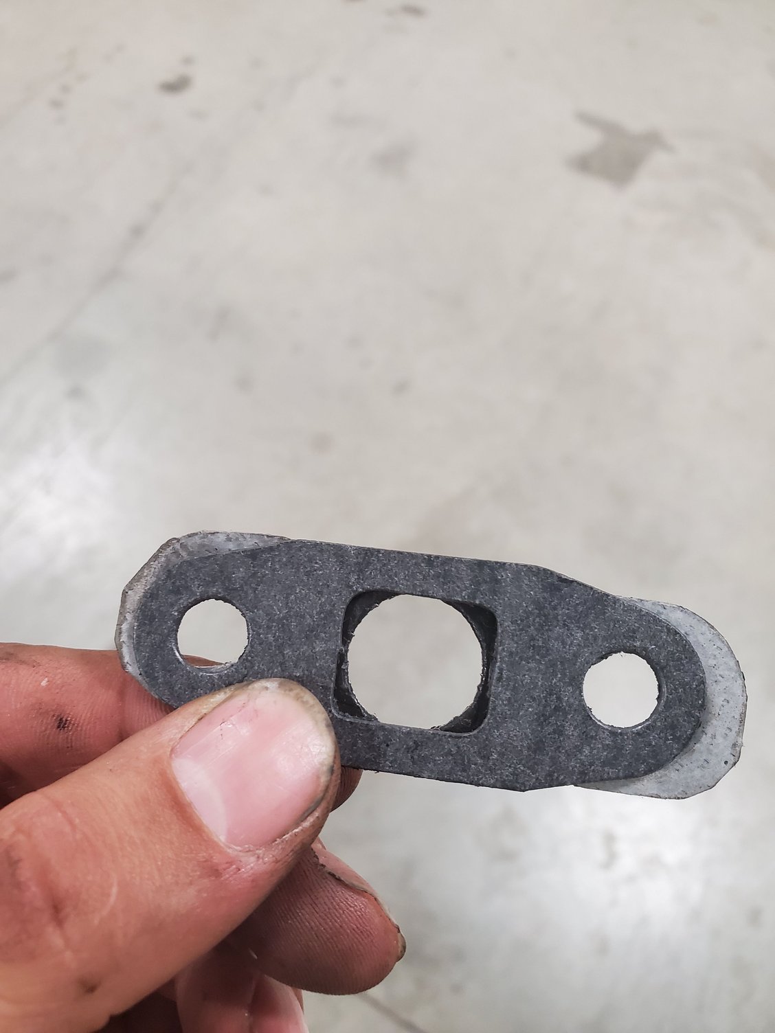

I ordered a gasket kit for a 5.9 Cummins, figured most all Holset turbos probably had the same feed and drain gaskets.
Man taking the drain line off is a pain with the turbo still attached. Yall with the stock turbo are lucky, doesn't it just mount straight to the pedestal?
Anyway, here's the proper gasket on top of the shoddy one I made fit. Wouldnt think thats a huge enough difference to make it leak but well see.

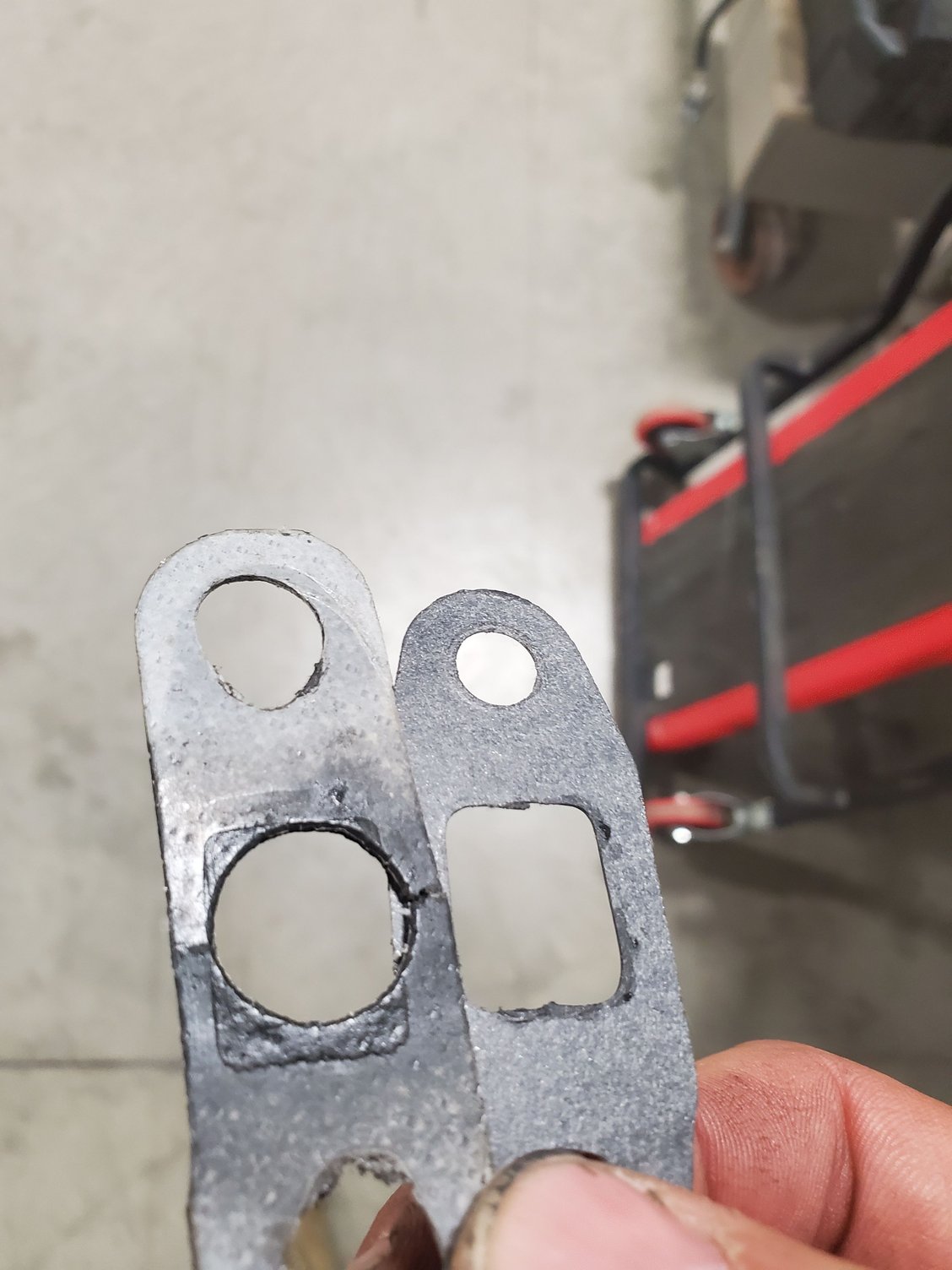

I did do an efuel conversion. Thats what started this whole debacle. My drain is going to the stock spot. Its a bendy steel tube.
Here's a better pic that shows how much the crap gasket was blocking
My truck seems to be running fine and is not leaking now after swapping that gasket. Boy was it a bear changing it without pulling the turbo. Only had to pull the intake Y
