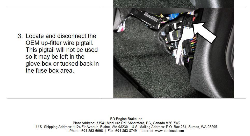

Their instructions says to disconnect the Upfitter Harness. Makes me wonder if this disables the Upfitter switches?

I had the exact same question and concern before purchasing the BD high idle kit for my 2017. I'm happy to report that the Upfitter switches DO work after installing the high idle kit.
Those customer access wires have nothing to do with the upfitter switches. Poor choice of connector label on their part.

upfitters are under the hood, this pic is not them.
