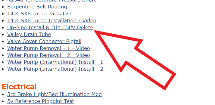

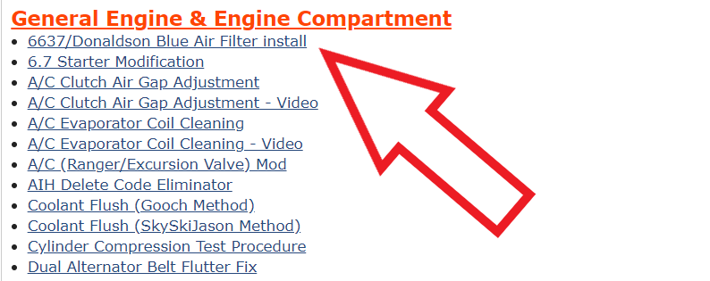

SSJ, is there a write up on the 6637 install in the tech folder? I have wanted to share a link with people before and looked but couldn’t find one.
Like this?
https://www.ford-trucks.com/forums/1...th-extras.html
And since I’m looking...
https://www.ford-trucks.com/forums/1...lete-pics.html

Yes exactly like that!
Neither of those are in the tech folder that I can find. I wonder if this is something that could be added as these are a couple common mods.
Otherwise I need to find another way to quickly reference them to share with folks.

Added to the 7.3L PSD Tech Folder as seen below. Thank you for the suggestion and for helping keep the Tech Folder current.
