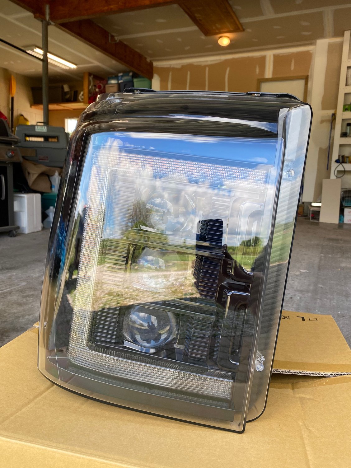

If anyone is interested, I am selling my Morimoto XB LED headlights from my 2011 F-350. They are the full projector/led type.

$1000 +shipping. I just traded in my 350. Had them on for about a month. Light output down road is excellent and high beams are amazing.
