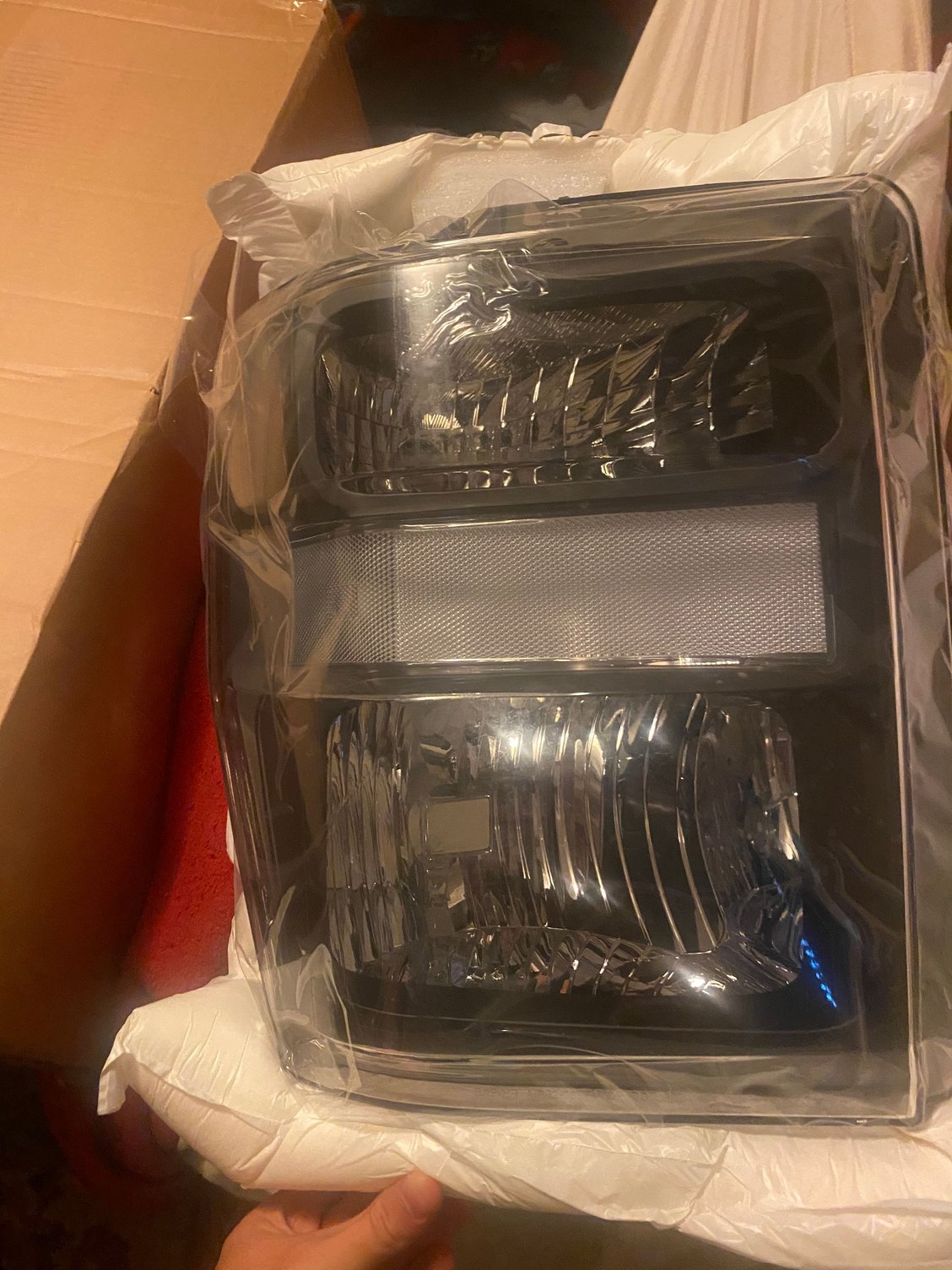

So guys I need some help! I recently purchased new headlights and led bulbs to replace my sealed beam halogen! I tried installing them and everytime I try to turn them on my low beams keep blowing the fuses!! My high beams work perfectly but low are blowing every time! Now the leds I have don’t have a ballast connected to them so I’m wondering do I need to get some with that or what? That’s what I’m guessing my problem is but I would love to hear what y’all have to say!

it’s a 08 F-250 and not sure what exact bulbs they are as they came with the headlight housing I ordered! I currently have sealed beams so I’m doing a h4/h13 conversion and the led bulbs I have do not have a ballast or anything with them so as soon as I turned on my lights it blew my low beam fuse. I replaced the fuse and put my halogen back in and works fine so I’m guessing I need a resistor or something?? These are pics of the lights and bulbs I ordered
