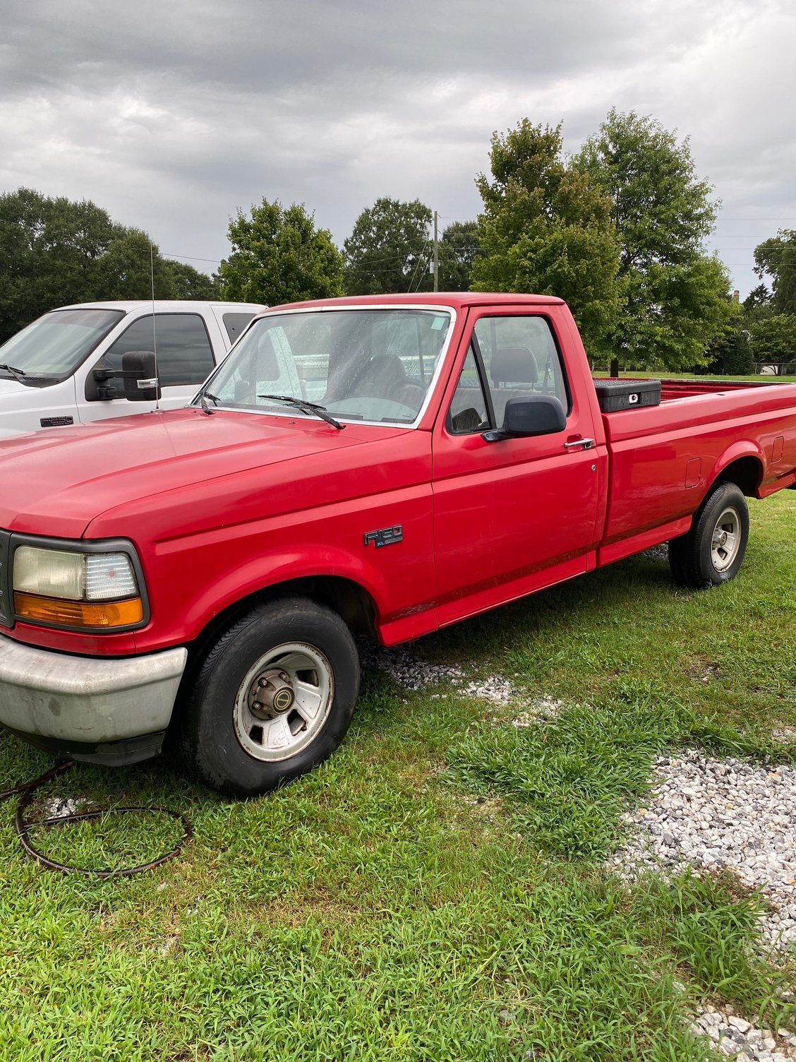

Thanks to jobimi, mark and the others for asking/answering this question. I came here to search for it and all the information was 3 posts down. I also acquired a truck with 66k for my younger brother with similar circumstances as the OP. Spent today freshening it up with plugs, wires, oil, belt, etc. Tomorrow the transmission fluid/filter. All of the belts plugs wires were oem still. It is a 1 owner XL that is rust and almost completely dingless.
