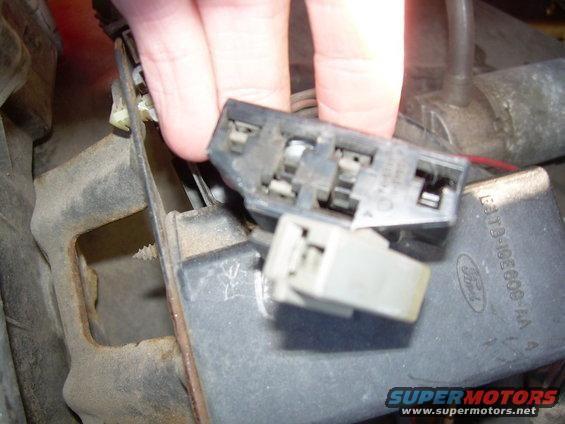

Its under the hood on the drivers side inner fender behind the airbox...

Should be under a cover
As already mentioned the diagnostic connector is on a bracket aft of the air box. When you do the test it is very important to list the codes how they appeared ie active or stored.
