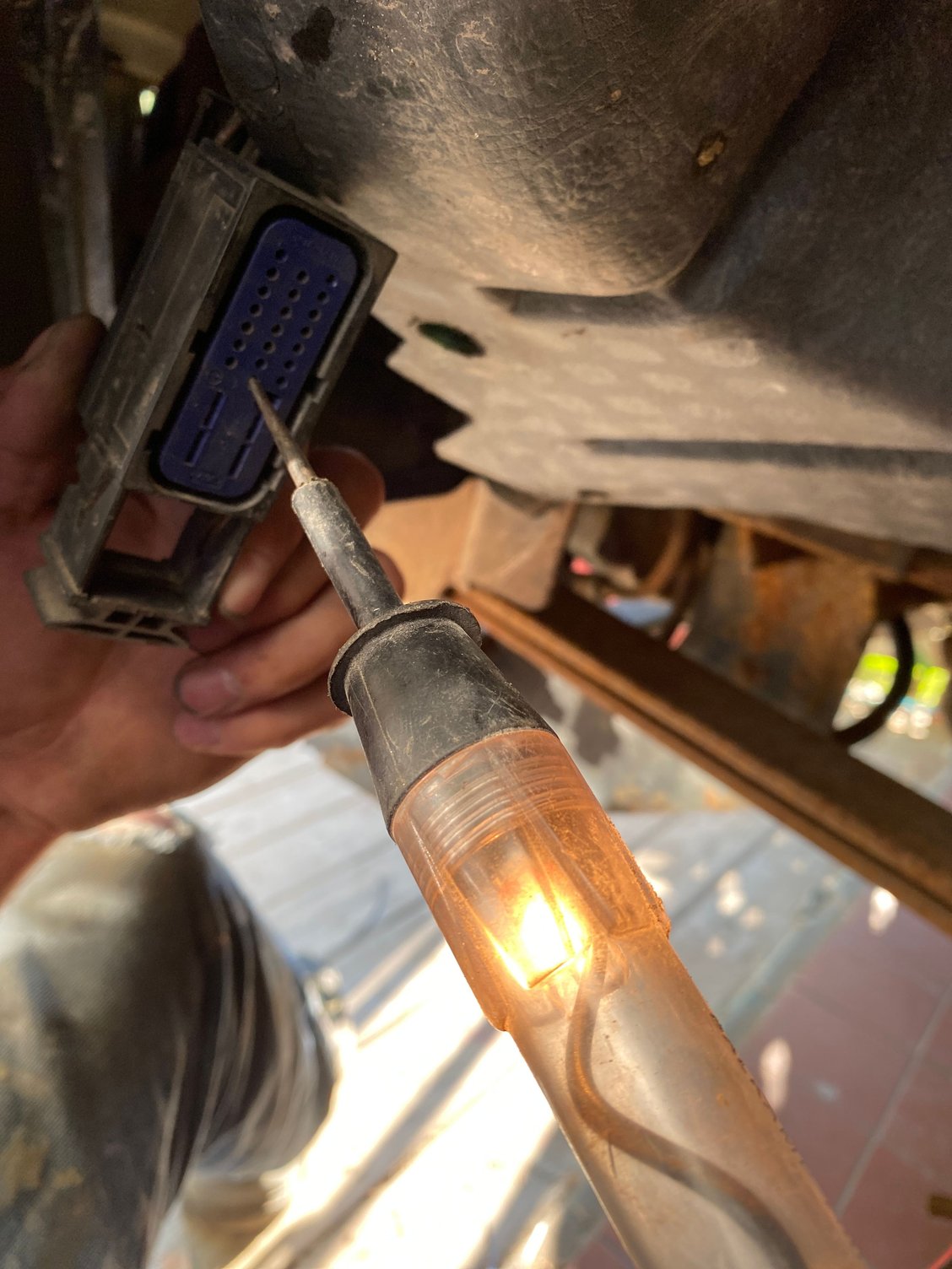

Been going off from this I’m on page 21 pin point test k and the prongs that’s says to test voltage I have nothing. I test this prong and it lights up I pull the fuse and it shuts off....does the early 03 diagram not relate with a 2004.5?

Found the issue the wire chafed/broke before the last connection before it went through the firewall. All fixed no codes or light

Good find! Good job too doing the pinpoint test. So many would jump to a bad module.
