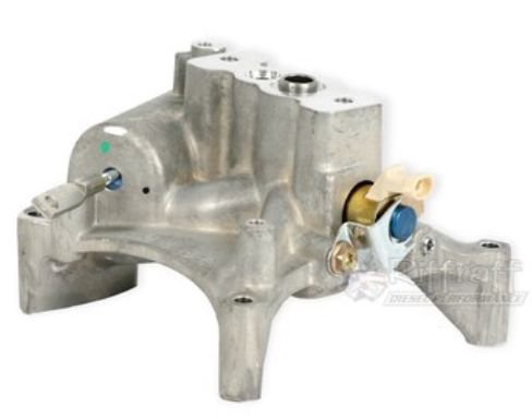

The EBPV connector is on the right side of this photo (stolen from RiffRaff site, thanks Clay)
Like someone mentioned it’s possible you have a deleted EBPV pedestal and no solenoid. Or it’s just not connected.

got it finally....I'll bet someone put a EBPV delete kit on it that I just found is available. I was confusing it with a EBPS on front of engine. Thank you all so much.
