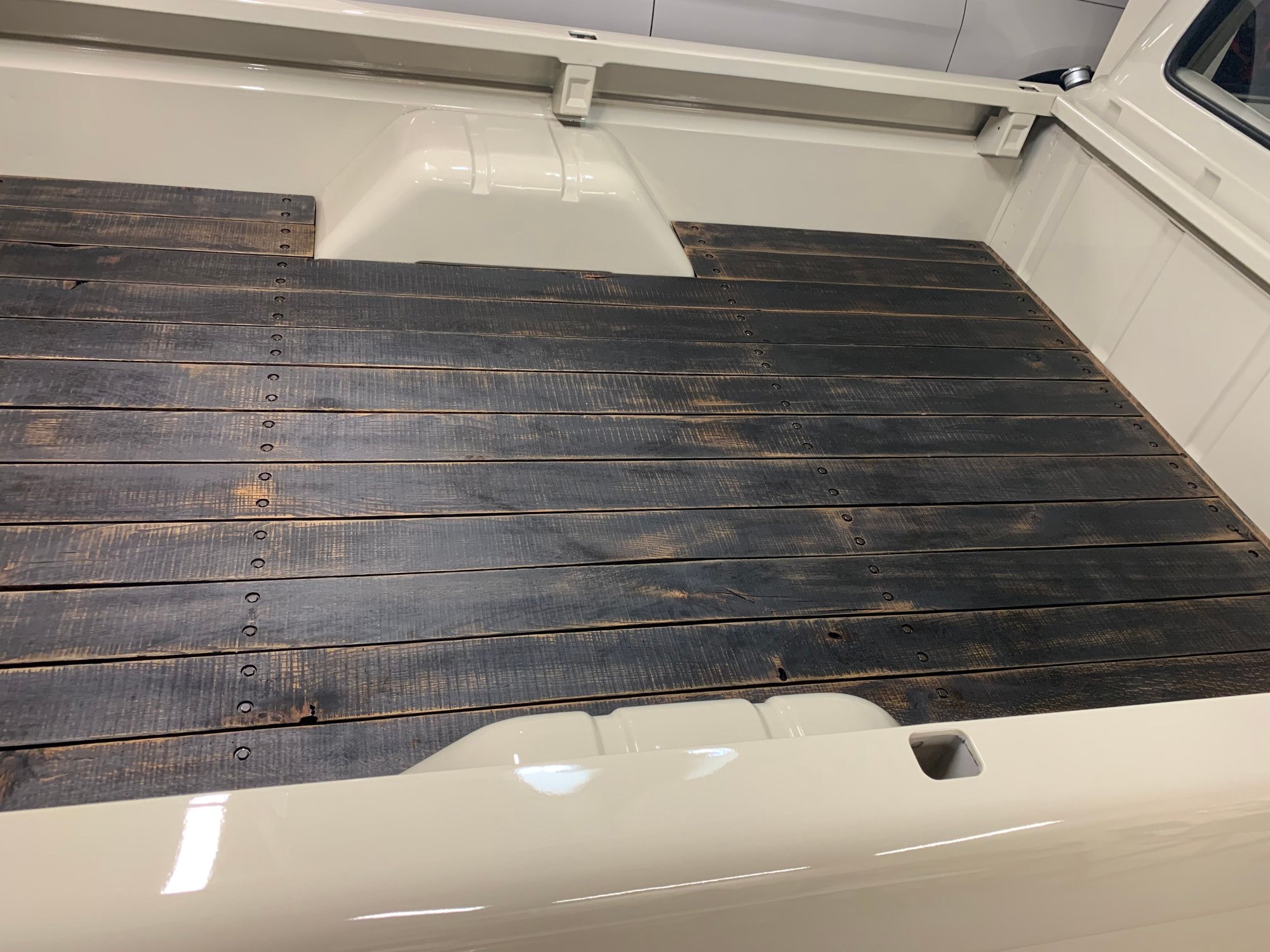

So I wanted a wood bed...my bed was in excellent shape, but still wanted that wood look! Didn’t want to rip out existing floor panels. Thought about Horkeys Show Deck, but price was crazy and their response was not very good considering how much I was going to spend. So I decided I can do the same thing, with a little planning for far far less. Spent a buck fifty on red oak from a local saw mill and used a 2x4 floating floor for support. Staining and fasteners next!

I think the largest problem you face is a moisture trap. Try to locate another bed with a bad floor that you wont feel bad about cutting up and go from there.

thought about that but hopefully won’t be too bad as I keep the truck in the garage and don't really drive it in crappy weather. I will keep a eye on it to make sure nothing going south on me!

You could cut small vents into your support bracing which would allow for airflow

Just finished my wood bed. I took the use from Horkeys Show Deck. I can remove everything if needed as it’s a floating design. I gapped the boards for airflow.
