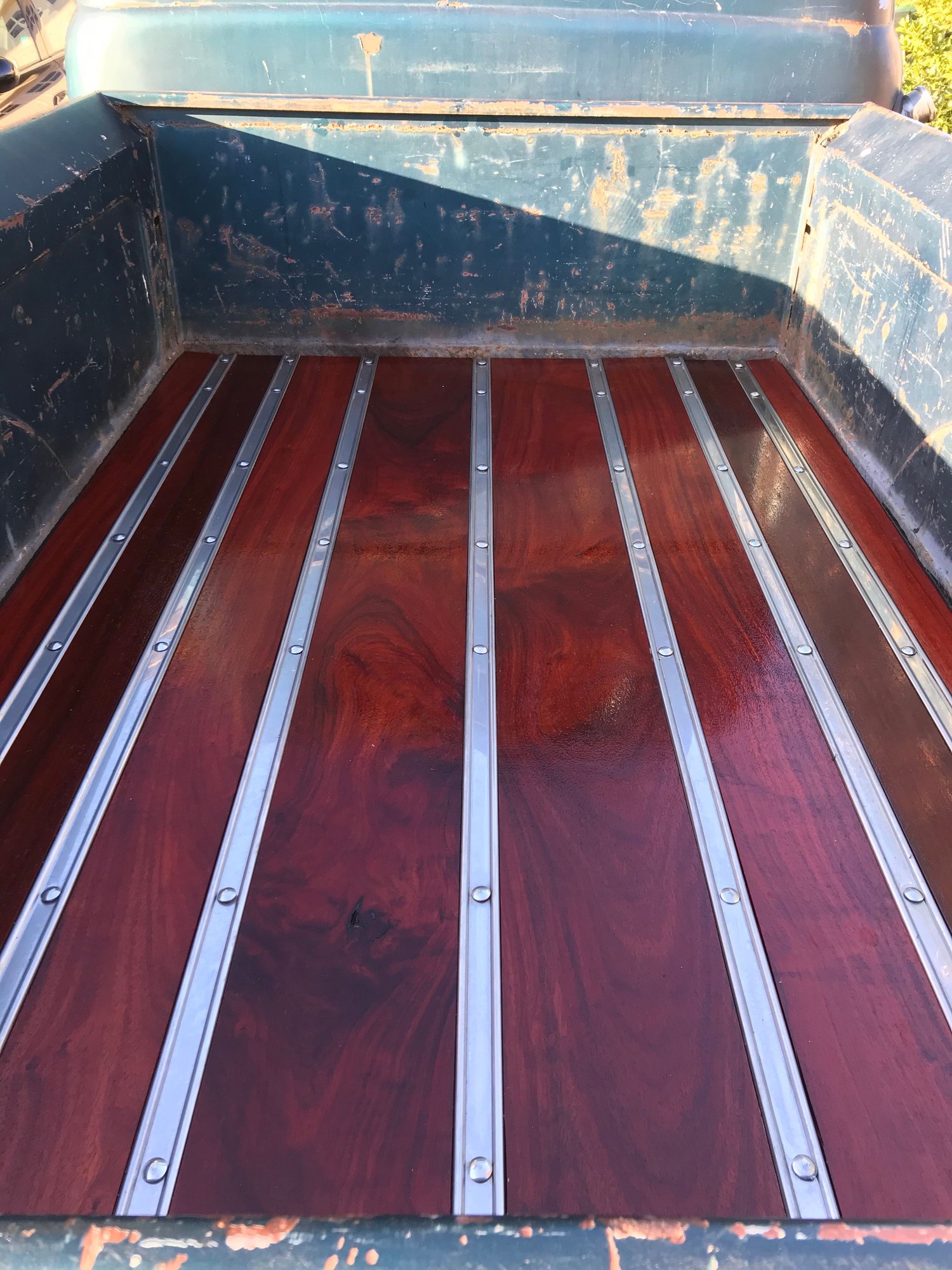

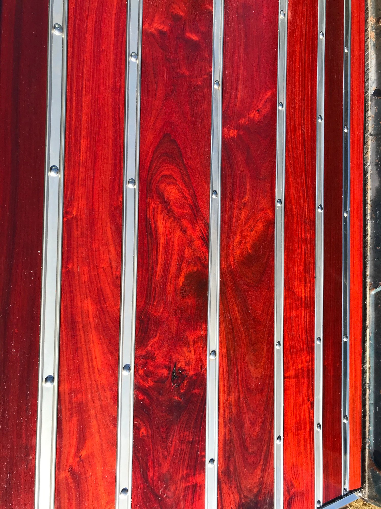

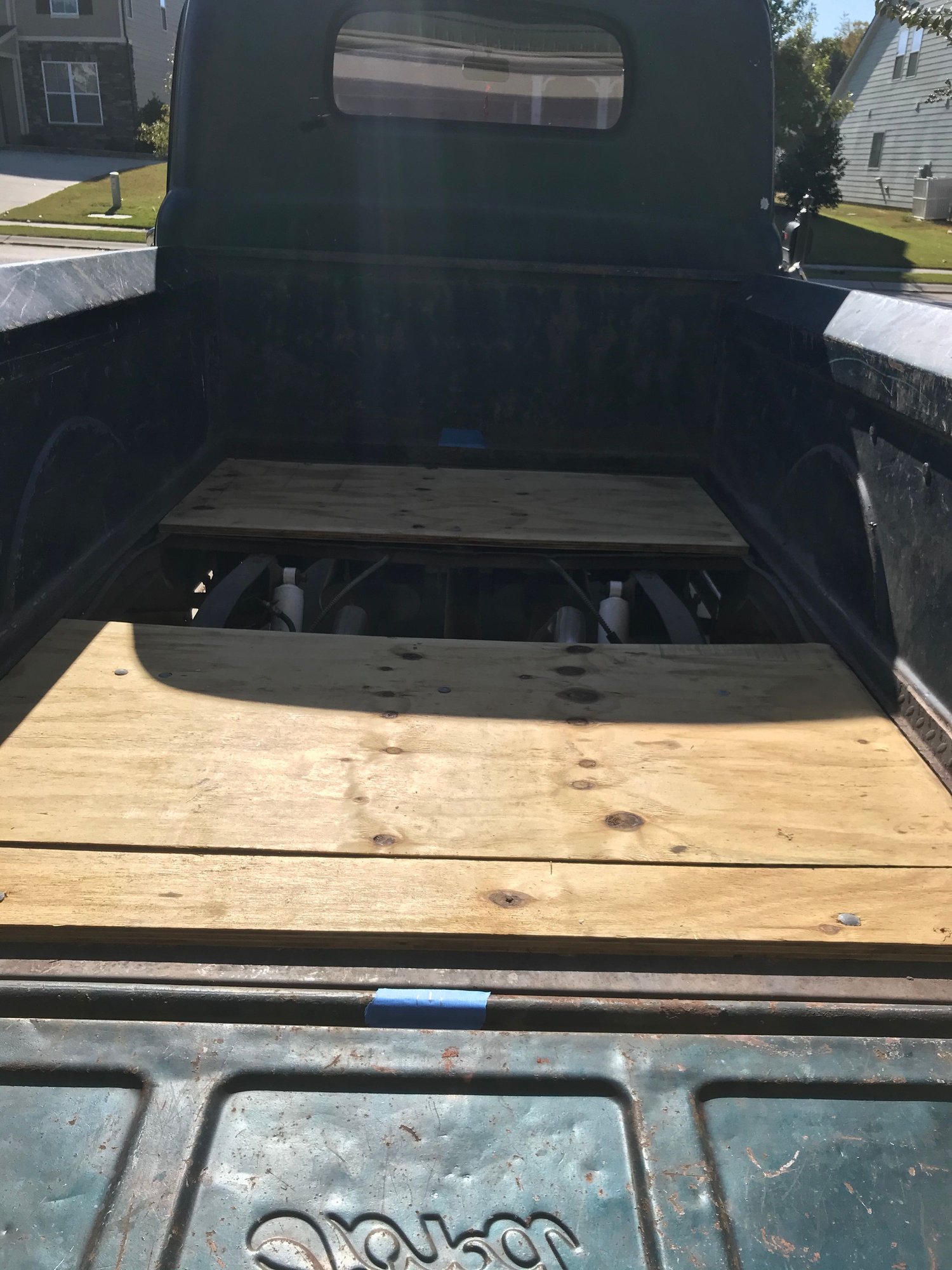

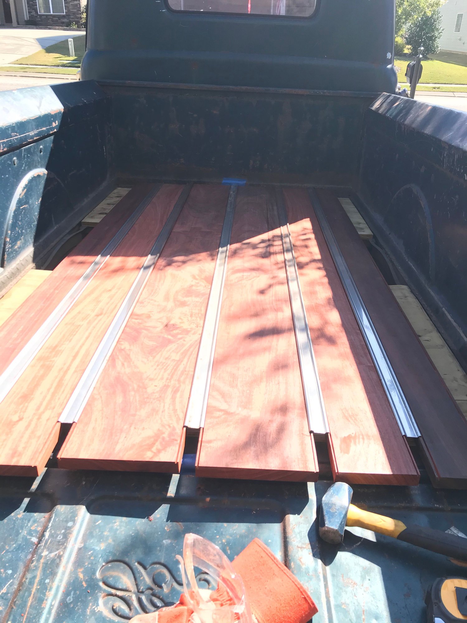

I had some paduak laying around from another project, and decided to use it for the truck bed. It's a wood that is orange(ish) when sanded and quickly turns brown in the sun. Sometime in the trucks life a bed was welded in with diamond plate, but just the angle iron remained when I got it. I used marine ply wood as the base to get a level surface, the put the bed wood on top. I used the table saw to cut the grooves for the strips. Stainless strips and carriage bolts from DC, with longer carriage bolts from Lowes. Finished the bed with 3 coats of Sikkens Cetol marine gloss.
Sub floor to get level
Getting Paduak sized
Finished with 3 coats of Sikkens retool marine
Nice grain.

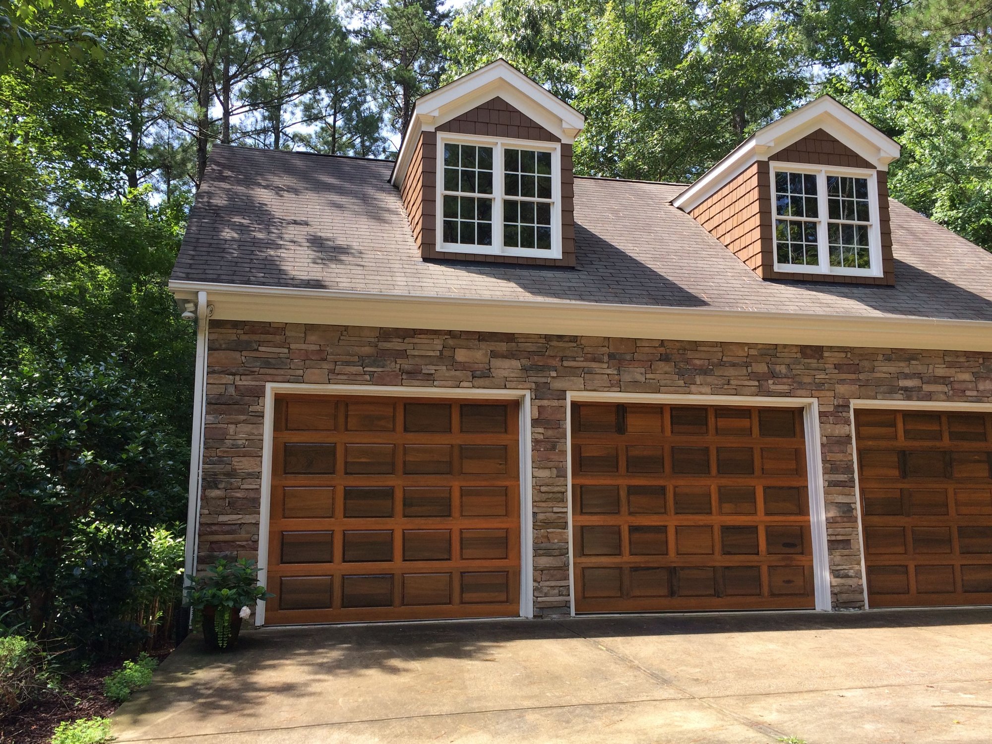

I used the Paduak to build some garage doors because it is very rot and insect resistant, much like teak at a fraction of the cost. A side benefit was insulation, the wood is very dense and heavy, so the garage required little heating or cooling. It has an oily nature so wiping with acetone before applying any protective coat is best. Easy to work with, fairly inexpensive (compared to teak), and the reddish brown color that settles in is nice. Luckily I had enough left over for the truck bed.
Garage doors made of Paduak
