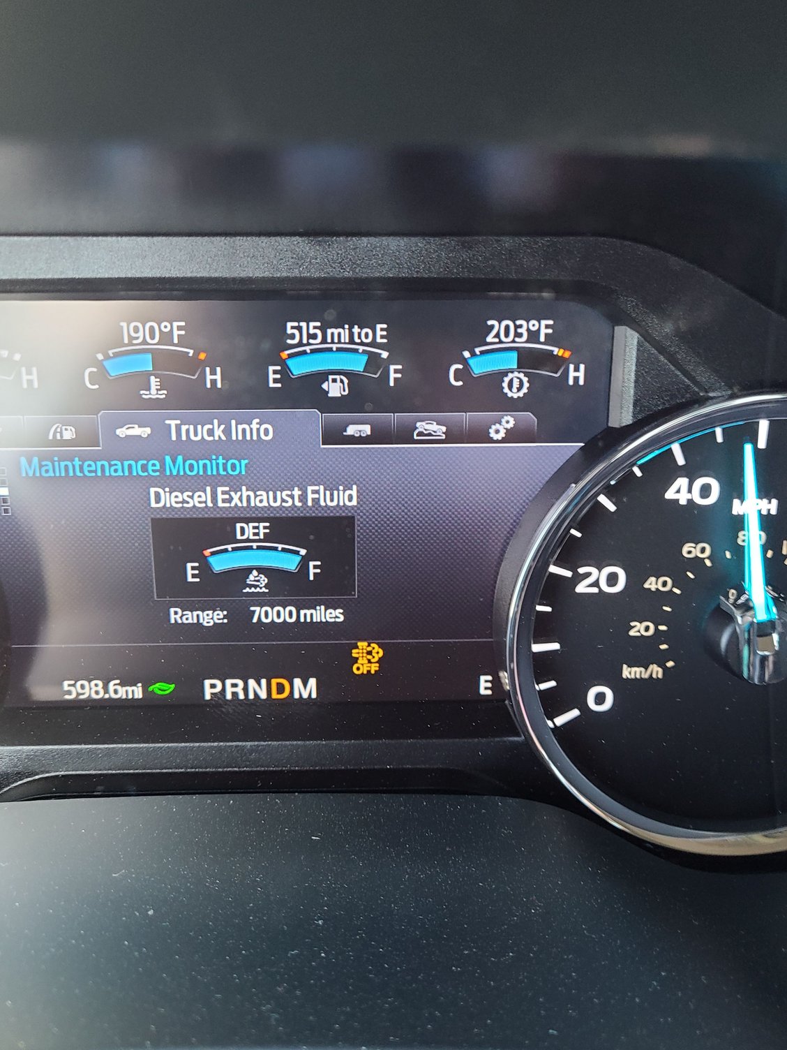

So no regen yet...

Originally Posted by ford390gashog
So no regen yet...
Why are you posting pixs of your DEF gauge? That has nothing to do with a regen. Your truck injects diesel fuel into the exhaust during a regen.
DEF is constantly being squirted into the SCR.

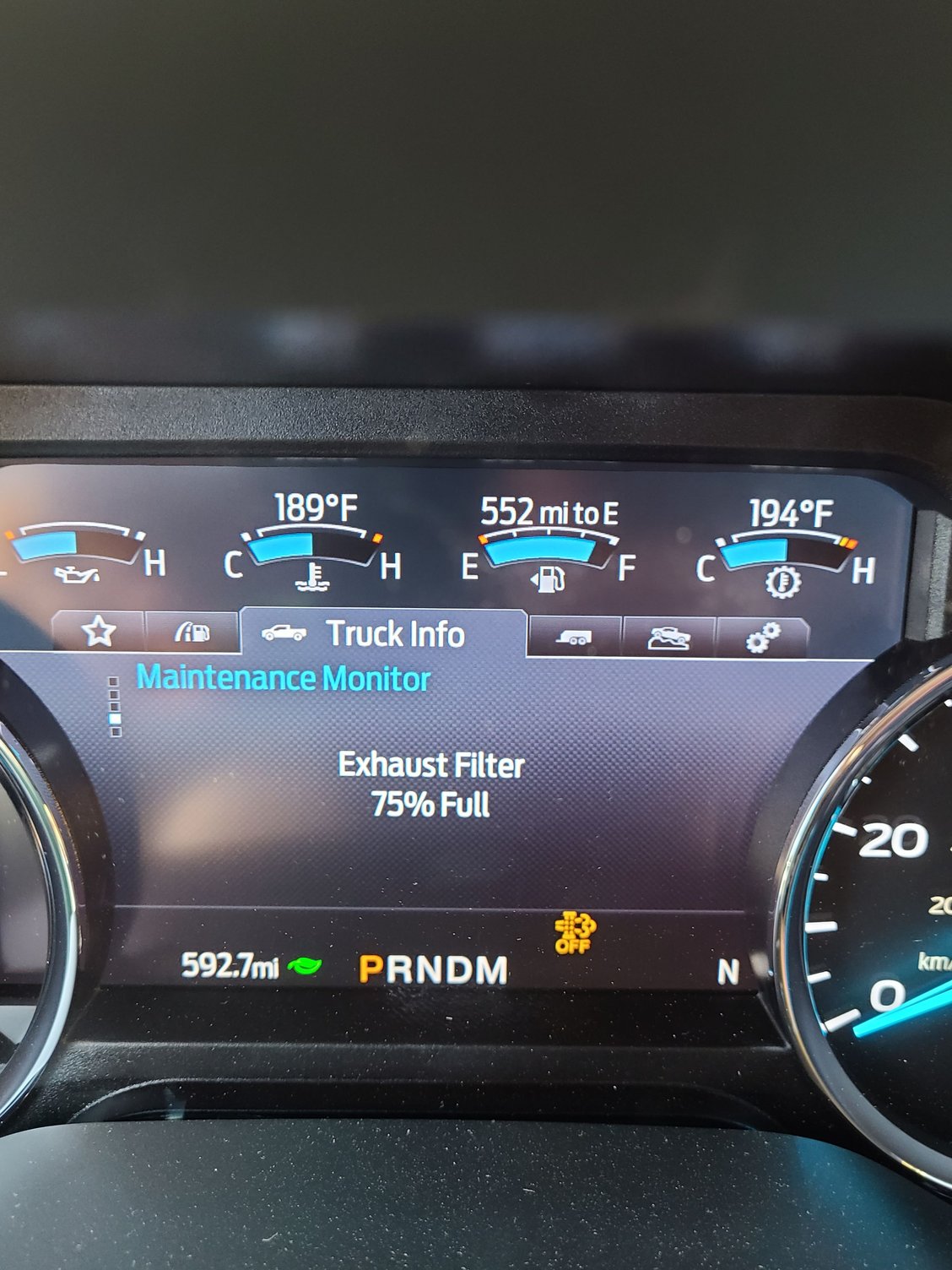

2020 Gen-3 6.7 First regen right at 599 miles.
Did you get your screen activated?
CPO, Good Afternoon. No, I've been keeping a close eye on the instant MPG screen and after seeing a couple of posts saying their regen hit around the 600 mile mark and sure enough, mine hit at 599 miles and saw the instant MPG go down significantly.
