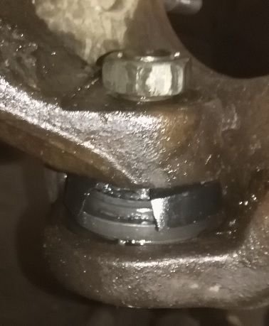

I'm installing new ball joints on my 77 F150 RWD - the passenger side went ok but on the driver's side, my 1st mistake was I forgot to put the boot on. My 2nd mistake was trying to take the spindle off. The ball joint studs ended up turning with the nuts so I couldn't tighten up the ball joints. I tried to hold the stud from underneath with some plyers, but that didn't work. I did manage to get the top one tight after hitting the spindle from underneath with a hammer, but the bottom 1-1/8 nut won't tighten up or come off. I will try to fill it with grease to see if that makes a difference, then, I'll try to weld on a piece of rebar or something on the top of the stud to hold it long enough to tighten up on the nut.
P.S. I cut the boot and slid it around, thinking I could glue it together just enough to keep most of the grease from coming out or dust coming in.

is there room the get a c-clamp on there to put some pressure on until you get the nut off to replace the boot? if not, how about a pair of large water pump pliers to put pressure on there...

I put a jack under it and jacked it up so there is a lot of weight on it.

I've got maybe 3/16" space to get in there. I'm going to try a large c-clamp to go from the top of the stud to the bottom of ball joint where it mates to the bottom of the spindle.

What carravaggio said. Always works for me.

It's a 77 with 4WD. I managed to get it to tighten up by putting a c-clamp around it.

that's good...you won't have much luck trying to fix that dust boot though without replacing it :-)
