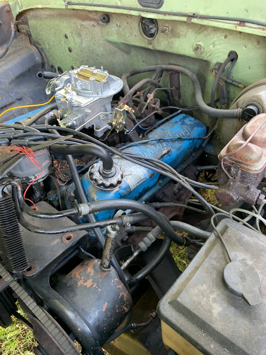

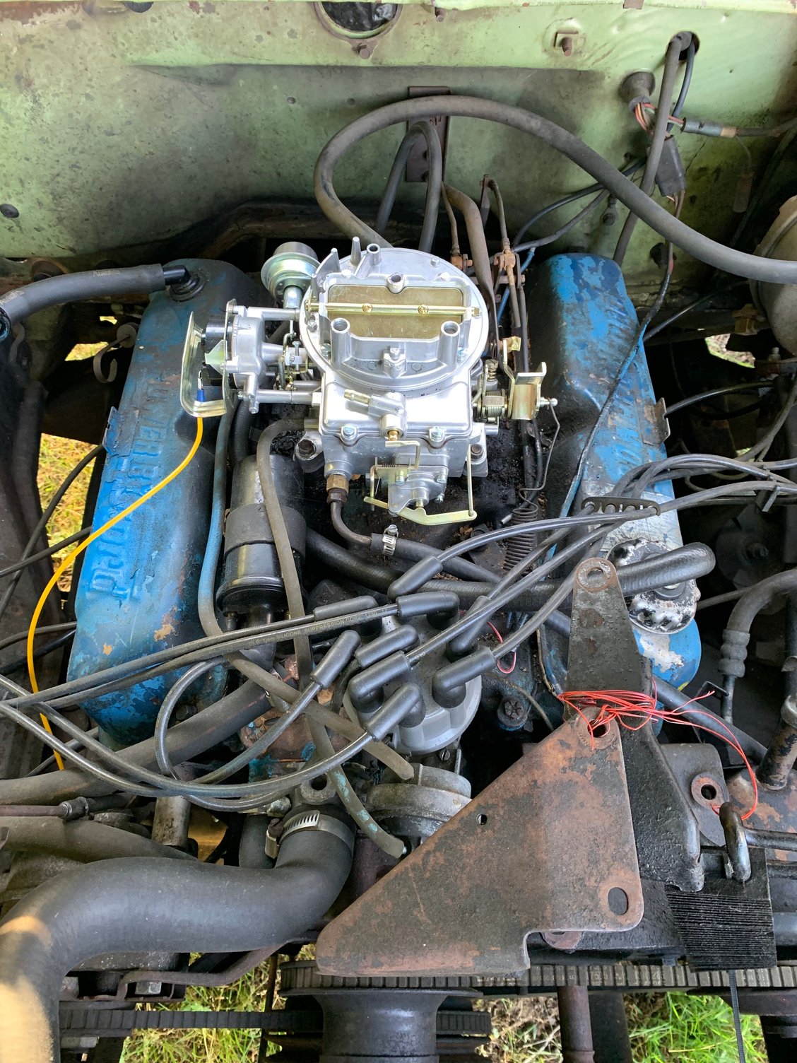

Did the 302s use the same 2bbl 2100 carbs as the FE motors? If so, that carburetor looks like it is missing a couple things. I dont see a dash pot or choke pull off. It just looks like a totally different carb. Here is what mine looks like on my 70 with a 360FE.
