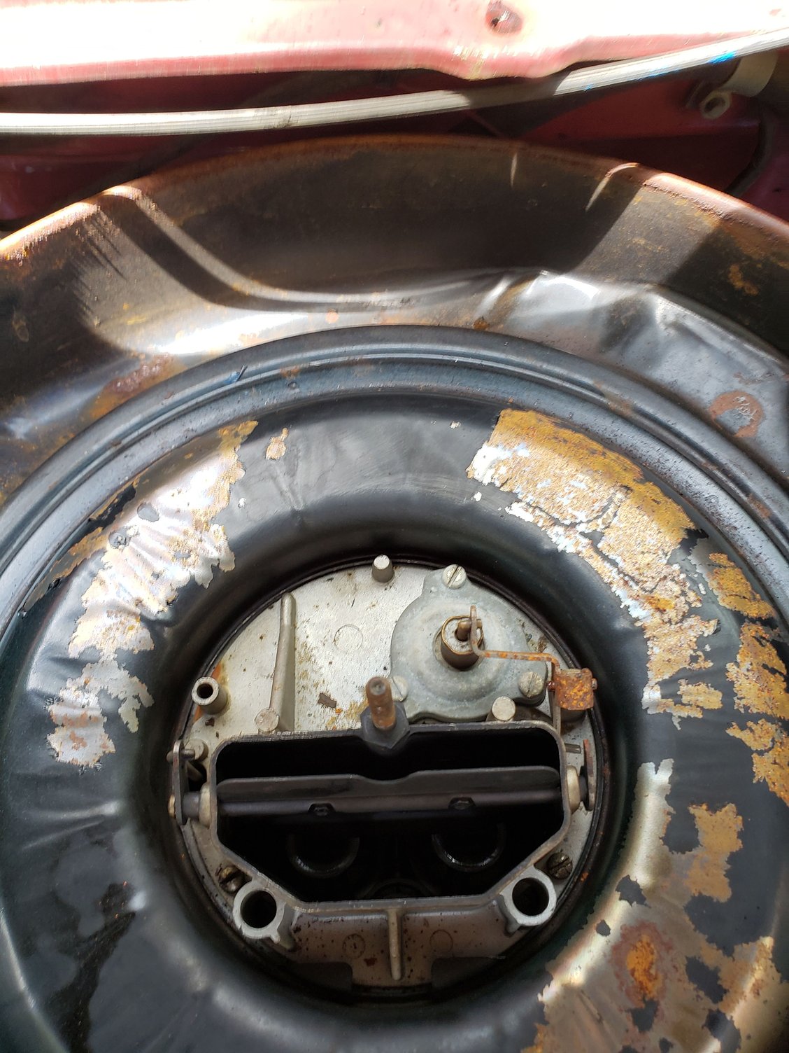

1973 Ford F250. Starts up fine and runs fine. But not until the temperature gets to mid level. if i put it in gear before it gets to temp, it stalls every time. Once it gets to temp it runs fine. I usually start it and walk away for 15 minutes. Any advice?

Have you looked at the position of the choke butterfly after you start it? Is your choke pull-off working and set properly?

Well. Here is what it looks like and doesn't move much when I get it going.

It should be almost closed until the engine is warm. Is this an electric choke? What does the rest of the carb look like?

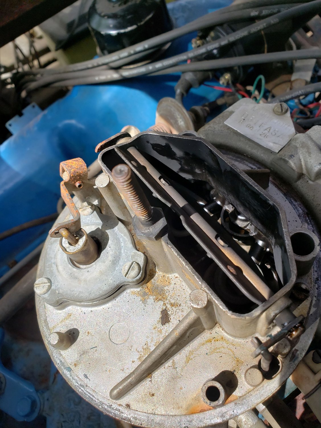

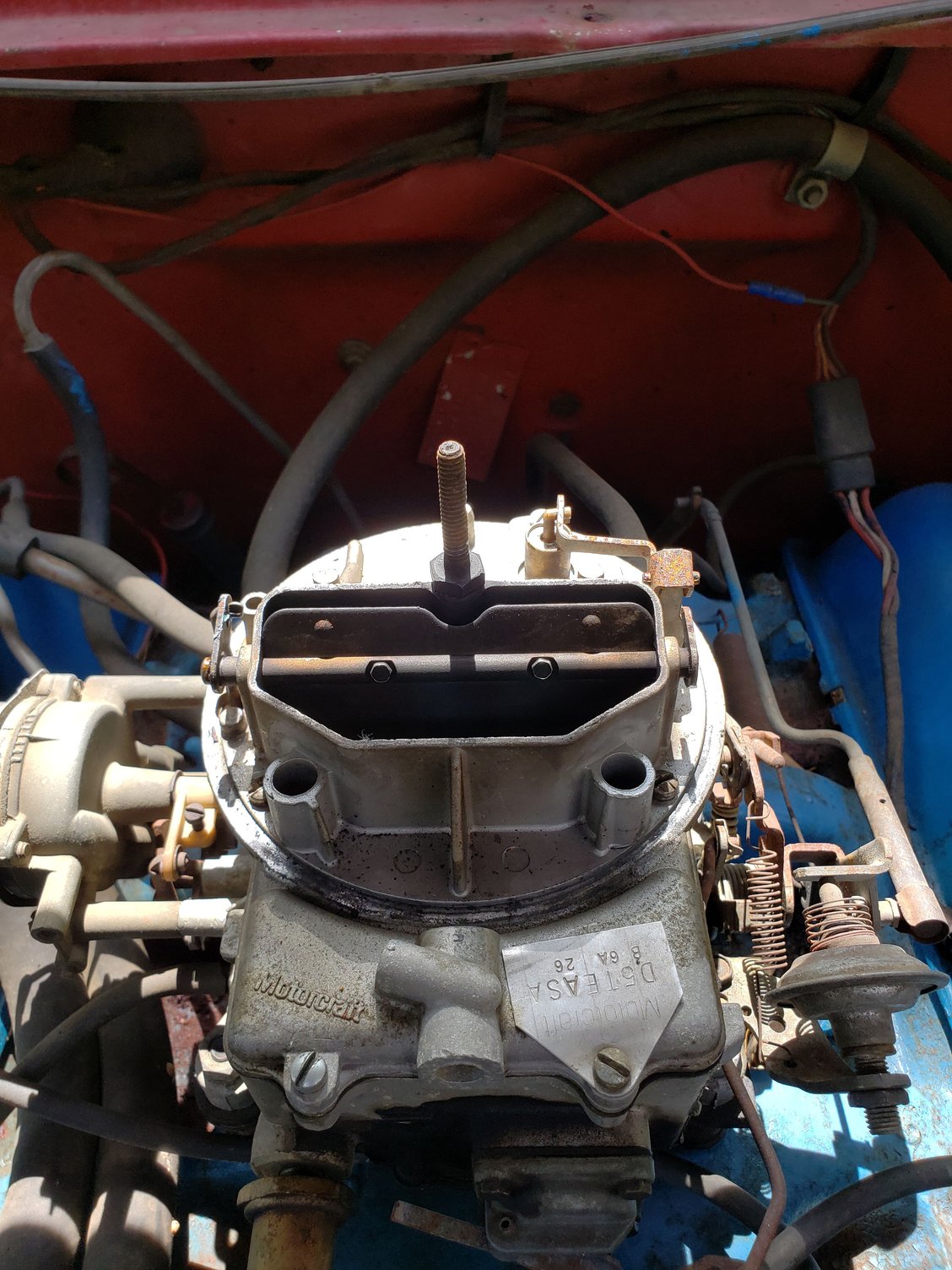

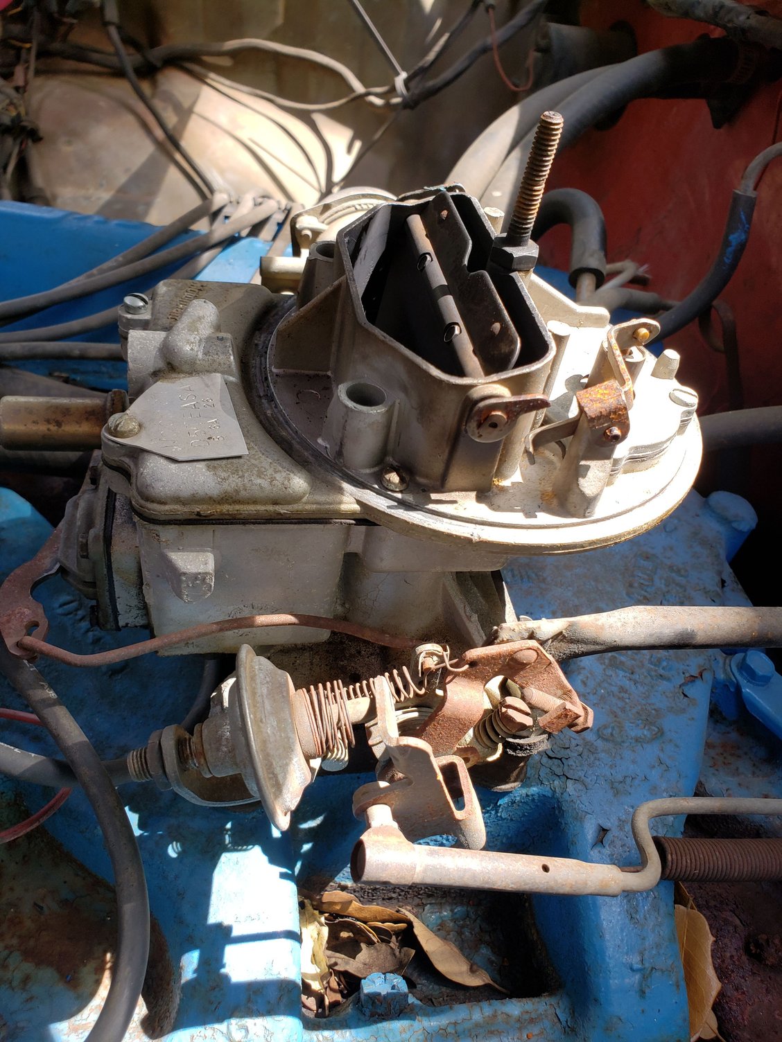

Thanks. It's not manual and here are additional pics. Thanks again

this helped out. thank you. i found the problem and that is i need to either rebuild or buy a new carburetor. whats the recommendation for best place online to buy parts. i can get it at auto zone, napa, etc but just wondered if there was a specific place folks go to in this forum.
