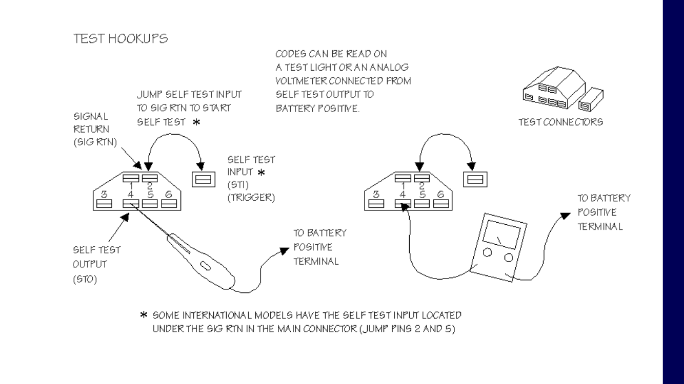

Is this how you were doing it?
Disregard meter/ test light if watching check engine light.

No, I was jumping from STI to STO (4) and not applying any power other than what is activated by ignition switch. So I may have been doing wrong. My signal lights are screwy (a problem that existed prior to the current problem and I have suspected a ground issue. Based on subford's post, looks like I need to troubleshoot electrical issues and that may solve many problems.
