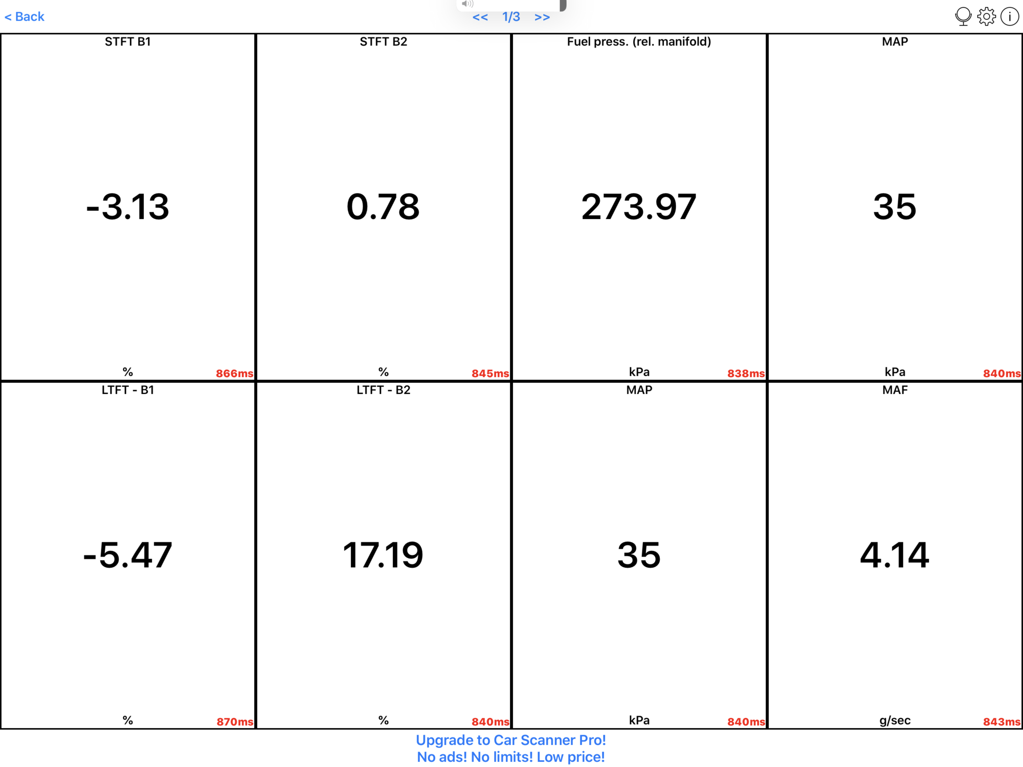

Attached are the scanner readings that seem relevant. Fuel pressure on bank 1 seem low? (Probably obvious). Not sure if the fuel pressure relative to manifold looks off.
any advice?

You won’t have phasers to worry about as that version of the 4.6 (in this generation truck) didn’t have them.
It does seem, if that knocking is in the valvetrain, that a valve isn’t closing for some reason and extra air is ending up in the exhaust stream and the pressure regulator is trying to compensate and lean out.

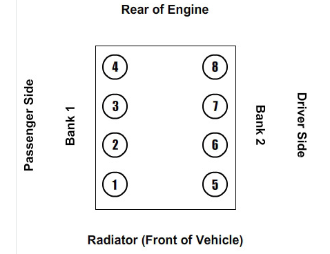

Bank ! is passenger side
See if you can look at mode 6 It gives you raw computer counts per cyl of misses and the amount it needs to set code .
