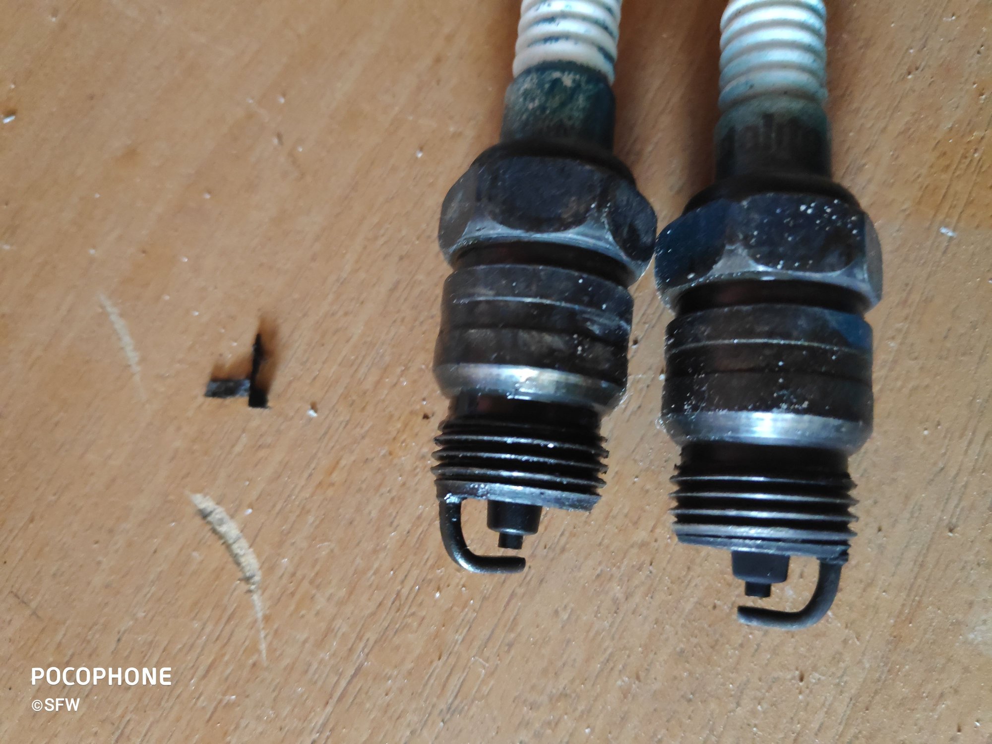

https://static.summitracing.com/glob...34630_js_s.jpg
This one...
And the pics
