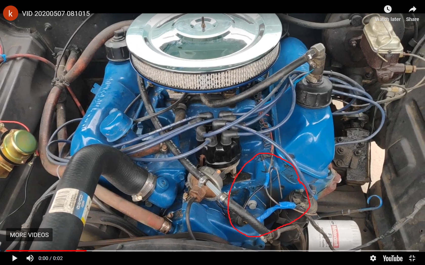

Oh, and that session you had with the extended period of idling could have overheated some ignition components from the other setup.
Not very likely with points inside the distributor, but depending on where the coil is mounted it's possible to overheat a coil. If it had electronic and an external black box/modulator it's very possible that it overheated.
As far as overheating parts though, about the only other thing that could suffer from this would be a fuel pump. And that used to be something we didn't worry about. Modern fuel pumps are not very high quality anymore however, so I would not rule out a bad fuel pump when looking for why the engine died.
Then again, with that wide open port sucking air at a much higher volume than allowed, you could have potentially burned a valve in the engine even from running too lean. However, just one or two or three would not keep an engine from running. It would not run well of course, but it would still run and that would show up in a compression test anyway.
Can you post an image of the black box you speak of?

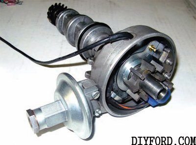

Originally Posted by 1TonBasecamp
Pertronix does make them for most distributors. But they are different for each application, so if yours is not for your specific model distributor that could be why it's not easy to figure out.
Also, you say things look sealed. It's possible that the previous owner installed a different brand of trigger mechanism inside already. If that's the case then that would easily explain why it's not looking normal. Since you've done it before, you would recognize how to do it now. The Ford distributors might be slightly different for your engine than the 289, but they should be recognizable as from the same family.
The reason they don't need any external black box is that the ON/OFF signal they generate is strong enough to trigger the coil by itself. Red wire to power, Black wire to coil negative. Just like the 289.
Some other brands require a separate modulator to interpret/amplify (some are actually called amplifiers) the distributor signal to something the coil can use.
If by "black box" though, you mean the one that goes inside the distributor from Pertronix, then yes you absolutely must have that since that is the signal generator (if that's a proper word here) that works with the black disc/cylinder thingy that slips over the rotor shaft.
Paul
HI,
with Black Box i mean the duraspark Box...
Compression is leaked is tested by me, everything ok. Passender side as 10psi more compression than driver side in average.
Vacuum in idle on the advance port is around 4-5 psu.
Fuelpump looks ok and works normal.
So ill have to get the ignitor Thing done somehow and i will put the flamethrower coil and also New sparkplugs in.
Also put a PCv in and Set the carb. After that, it should run!?
Any idea how to handle the distributor as it is slightly impossible to get a original one from this years...?
My's looks like this, pretty exactly the same.
So far it is Clear for me, that the duraspark Box is basicly a ampliefier but why there are so many wirings going through and why there is also something what looks like a spring in a half open housing (2cm x 8cm) connected? If it is just a ampliefier, plus minus and Signal in/out should be enough?
​​Anyhow, once the problem is fixed, I probably got a pretty ok understanding of These old engines. So May at the end its a good Thing as i planned to collect more of These cars in the future. I will stay with ford because IT is the beginning of car Industrie as we know it and where a live from
Yes... Don't change it yet.
Since it seems to be working to provide spark to the plugs, keep it for now. I don't remember, but did you check the inner module with an ohm meter?
At the 3-wire connector you put the test probes between the Orange and the Purple wires. You should see a reading of between 400 and 700 ohms. If it's outside of that range, or even very close to the limits, I would replace the stator and reluctor (the blue thing and the cogged wheel on the shaft) with one of the common kits available. Not expensive, and since they're small perhaps not too expensive to ship to you if needed.
[QUOTE=Steven Fleischer-Winkler;19294171]So far it is Clear for me, that the duraspark Box is basicly a ampliefier but why there are so many wirings going through and why there is also something what looks like a spring in a half open housing (2cm x 8cm) connected? If it is just a ampliefier, plus minus and Signal in/out should be enough?
Can you show us a picture of this spring and housing? And for the Dura Spark there should only be 6 wires out of the modulator for most models. Some do have more and I don't remember which one you have. I'll have to revisit that again too, since I seem to be having more and more trouble remembering important details about the discussions I'm in these days.

4. Re-check that wiring that DertyFerd mentioned. Did you put that blue tape there, or was that on the wires before? Did you remove it and inspect the wires? Did you change anything?

From now i am waiting for a new distributor which is ordered in the us.
Once it is done, I will put it in a go on.
