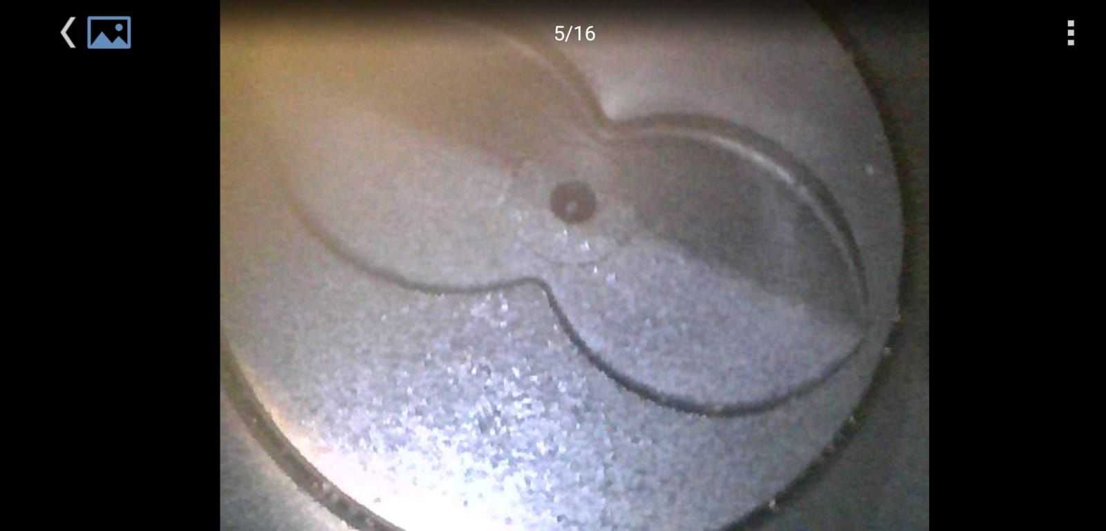

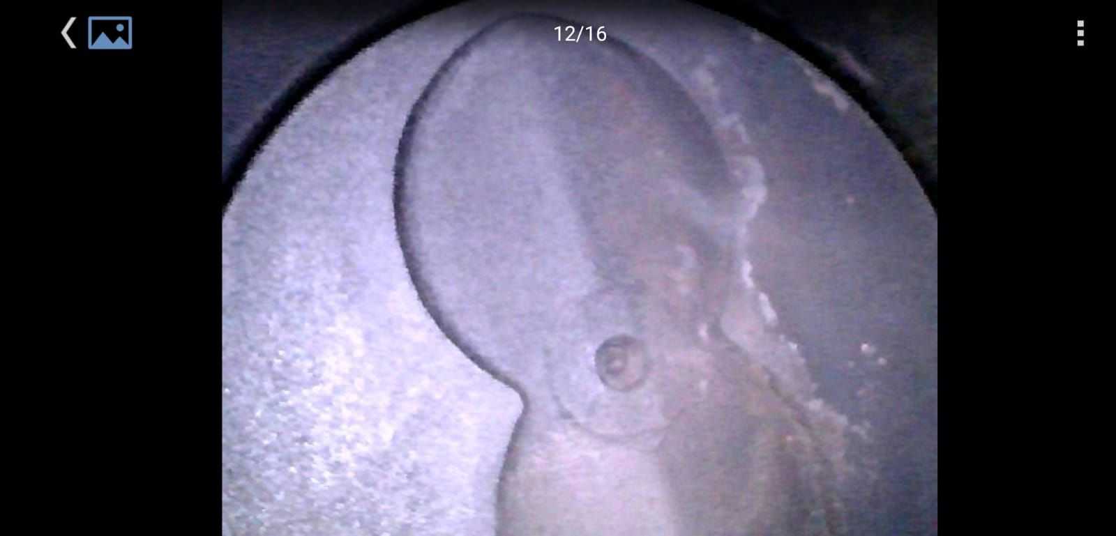

- checked plugs and ignition -> in idle and as i can check, all cylinders are firing at the right time
- checked compression > 95 - 100 psi on the right 4 cylinders, 100 - 120 psi on the left 4 cylinders (no idea why it is like that)
- checked carb and anything reachable by endoskop and did not found any damage or obvious problem
Please help, I ve no Idea what to do next. I can not find anything for the carb (like basic adjustments and stuff), I can not check the timing because i dont have a tool and this virus makes it impossible to get one.

Also checked the cylinders and pistons by cam, no Cracks or anything what does Not look normal...
