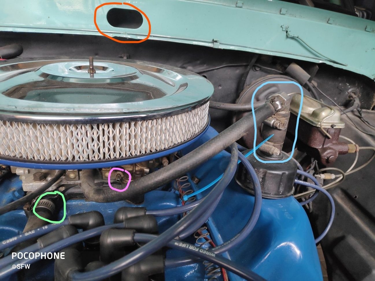

In the next to last picture, the vacuum advance port on the carb is not hooked up. On another picture, the vacuum advance hose is hanging down in front of the water pump. That indicates what the timing problem may be related to. Also, have you been running the truck with the PCV hose disconnected for a while? If the oil soaked plugs came from the passenger side bank, that also could be part of the problems. But, hook up the vacuum advance and it will make a world of difference.
Hey, could you Mark it in the pictures, I dont get it.
As it looks for me, everything is connected...
As i understand, just 2 out of 3 habe to be plugged because one is for Emission Controlled vacuum advance and the other one for Not Emission Controlled vacuum i guess?

I see what Dan was saying Steven, and have a couple of questions of my own as well about all three images.
In this first image, is the hose I have circled in fuschia a water hose? Is this one, along with the one in the last image connected to the heater hoses and to the spacer under the carb? That's what it looks like but I've not happened to see one on one of these vehicles before.
If so, it's just for cold weather running and might be a good thing.
And just a comment, but it looks like someone created the throttle linkage rod out of all-thread rod. This is not a real problem that I can see, especially if it works. But am just pointing it out so that, along with the carburetor, you know it's not original.
The oval shaped hole circled in orange usually has a rubber plug in it.
The port on the carburetor circled in pink is what Dan was referring to, and must either be capped/plugged/closed, or attached to a tube to the vacuum advance. Where does the hose from the front of your vacuum advance attache to the carburetor?
The green circled hose is just a coolant hose like I was mentioning before?
And a big question here, is the device circled in blue just a hollow fitting? This is where the PCV (positive crankcase ventilation) valve should go and is VERY important here. If this is just a hose with elbow fitting then this is a huge vacuum leak and will cause some of your symptoms. I would say take it apart and find out what is under all that rubber hose and clamps.
Finally, this is the other half of your PCV system. It is where the clean filtered air is allowed into the engine while the dirty air from inside is sucked out through the PCV valve in the other valve cover and mixed in with the fuel/air mixture.
From the factory this is attached to the air cleaner housing directly. Because you have an aftermarket air filter it looks like they just left it off. In this condition is it sucking in dirty air and can damage the engine over time.
See if there is a fitting on the underside of the air filter housing that you can attach it to. If not, I would create one. Or in a pinch you can simply attach a filtered cap to the end of the hose temporarily to keep the air clean.
The PCV system is one of the most important for the long life of your engine. It keeps the contaminants inside to a minimum.
If you do not have a valve in the driver's side cover with all that tubing, you should get one as soon as possible. In the meantime, you can disconnect it from the carburetor and cover the vacuum fitting. Or just plug up the tubing somehow. Then start the engine and see how it runs.
With the tubing blocked so that you no longer have a big vacuum leak, my guess is that the engine will run very differently.
Hopefully there is a PCV valve inside that tubing, but if not I would order one right away.

thanks for the answers and for the effort to edit the pics. The Blue L Fitting is just a connection which goes from the carb into the blue cover.
The advanced air is connected, it was just disconnected to check the ignition forwarder.
Now everything is connected and cheked and has the same status as it is was before the problem did appear.
Then you must replace it with a proper PCV valve for your, or similar engine.
Temporarily you must block it off. Remove the tube and plug it with a bolt, or if you have a vacuum "cap" you can remove the tube from the carburetor and cap off the fitting.
As an experiment, leave it connected, but plug the opposite tube (the one on the other side, in the last picture near the air cleaner) and see if this changes how the vehicle runs.
But either way, you need a properly working PCV valve.
