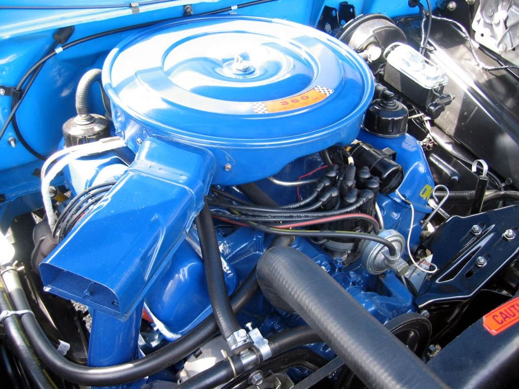

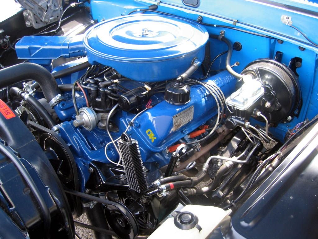

So you don't have an Edelbrock but this is the same style. The hose on the passenger side valve cover should be hooked to the air cleaner if there is a spot for it on the base. If not, you should put a breather in there because in theory it's sucking unfiltered air into your crankcase which is not good for your engine, but probably not the source of your problems.
Old May 18, 2020 | 04:37 PM
  #40
DirtyFerd's Avatar
DirtyFerd
Joined: May 2017
Posts: 414
Likes: 40
From: C-town,MD
Here's how it was stock with the PCV valve in the passenger side cover and the driver's side hooked to the air cleaner, but yours are reversed
