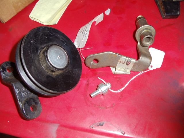

Like Numberdummy said, there's no bushing in the trans selector lever. When you disassemble the linkage you'll find the selector arm and stud both have wear. The only real solution is to replace both pieces. Replacing the stud is easy, to replace the arm you'll have to drop the trans pan and remove the valve body to get to the arm.

Here are the two parts you need. Ignore the A/C idler pulley.
