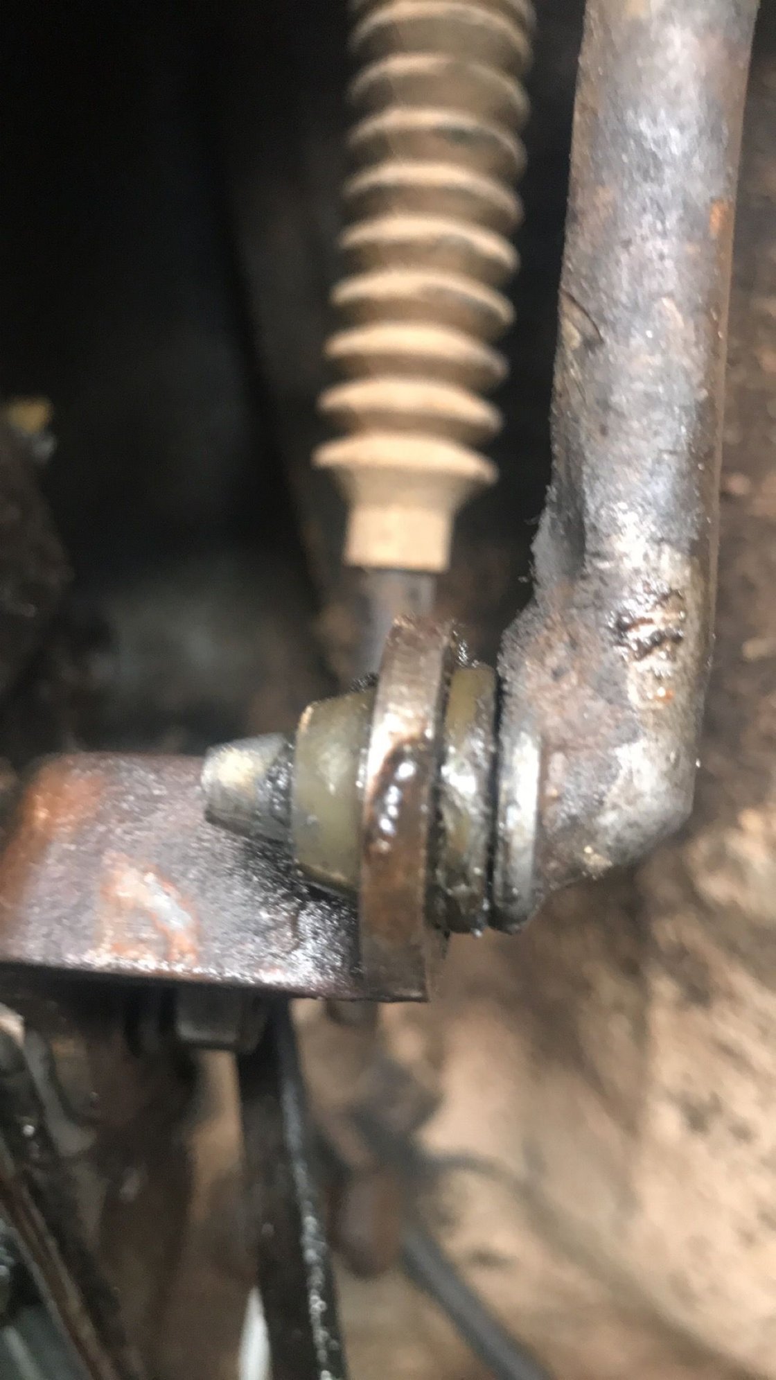

How do you replace these shifter linkage grommets

I pushed the old ones out using Channellocks. Pretty sure that's how I installed the new ones too (along with a little grease).
They're still available from Ford too by the way.

Originally Posted by Joseph Halkyard
What year/series is the truck? 3 M/T or A/T?
M/T uses different bushings (EOSZ-7341-A) than A/T (EOSZ-7341-B).
M/T bushing is obsolete, A/T bushing is available from Ford. MSRP: $5.87 each.

I ended up taking a knife and cutting one side off. Pressed the new ones on by pushing it down on my workbench after applying grease also.
I believe I bought mine from RA.
