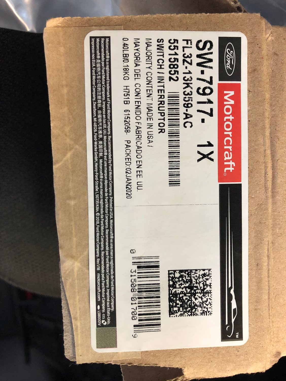

This morning, I went to the nearest Ford dealer to buy one. I wasn’t going to wait 3-10 days, or who knows how long if I order online. They had only one in stock and I bought it at $80. This way there is no shipping delay hassle due to all of this virus crap going on right now. Plus I didn’t want to drive around wiping a dry windshield for that long, which would wear out a pair of $40 blades and strain the wiper motor.

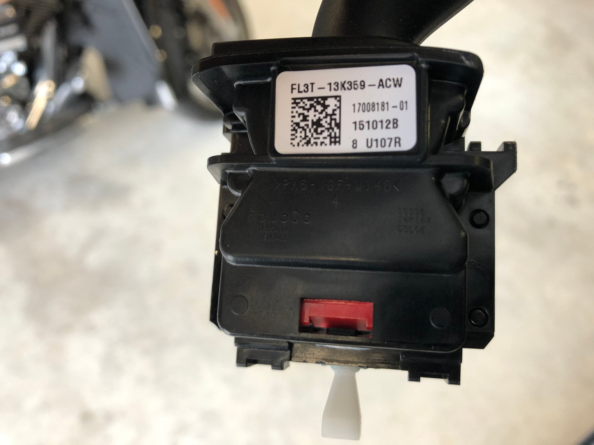

The new switch, made in 01/2020. The part number is different than the one I took off, so maybe there was an improvement.

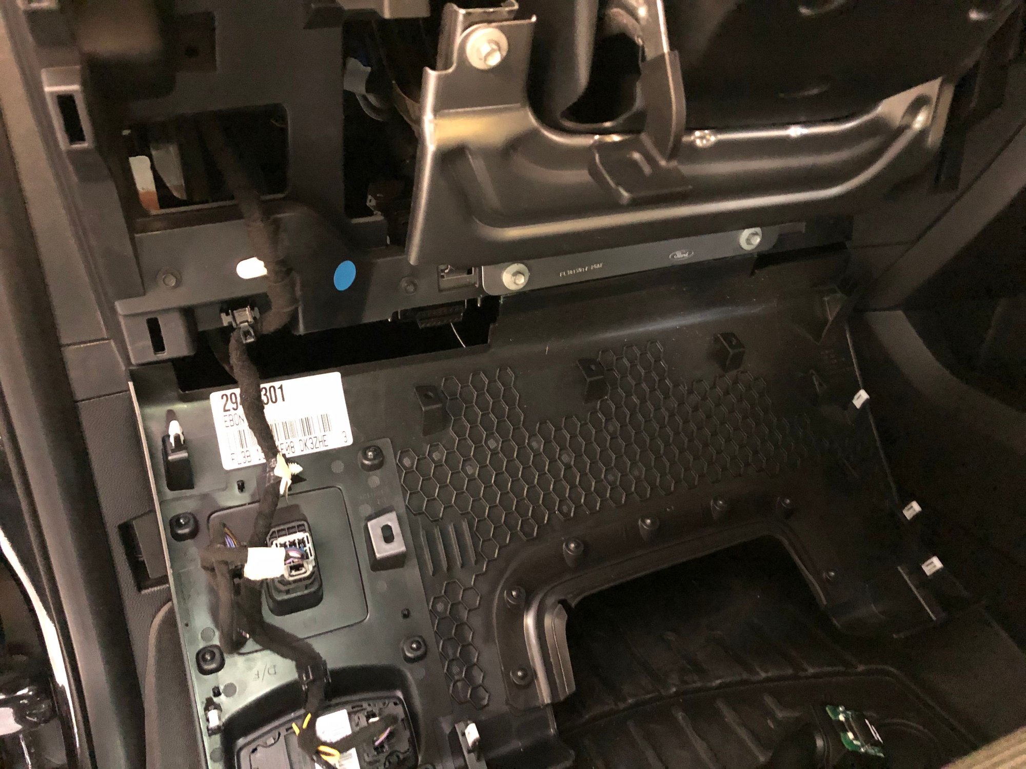

Start with pulling the lower dash panel down. It’s mounted with clips and will easily release by using you fingers to pull back from the top of it.
Under the steering column there are 3 screws. Use a 7/32 socket to remove them. Then separate the upper and lower plastic trim that’s behind the steering wheel. When you do, you will see the turn signal switch is easily accessed. Use a Torx 10 to remove the switch. There are 2 screws holding it in.

The new and old switch look nearly identical. Note that the old one is made in China and the new one is made in Mexico but the box says it’s made in the US. The old switch has a part number ending in ACW and the new one ends in ADW.

A word of warning. There are a lot of fake and used parts being sold online as new and genuine. Buy only from an authorized Ford dealer. A scammer could easily put the used part back in the box and sell it again to someone trying to save a few bucks.

Originally Posted by JKBrad
This is the PART number, notice that the prefix ends with a Z
This is the ID ENGINEERING number, notice that the prefix ends with a T
Ford PART number prefixes end with a Z or if a specific Lincoln part, end with a Y

Thanks for clarifying. What are the extra numbers behind the part number?
