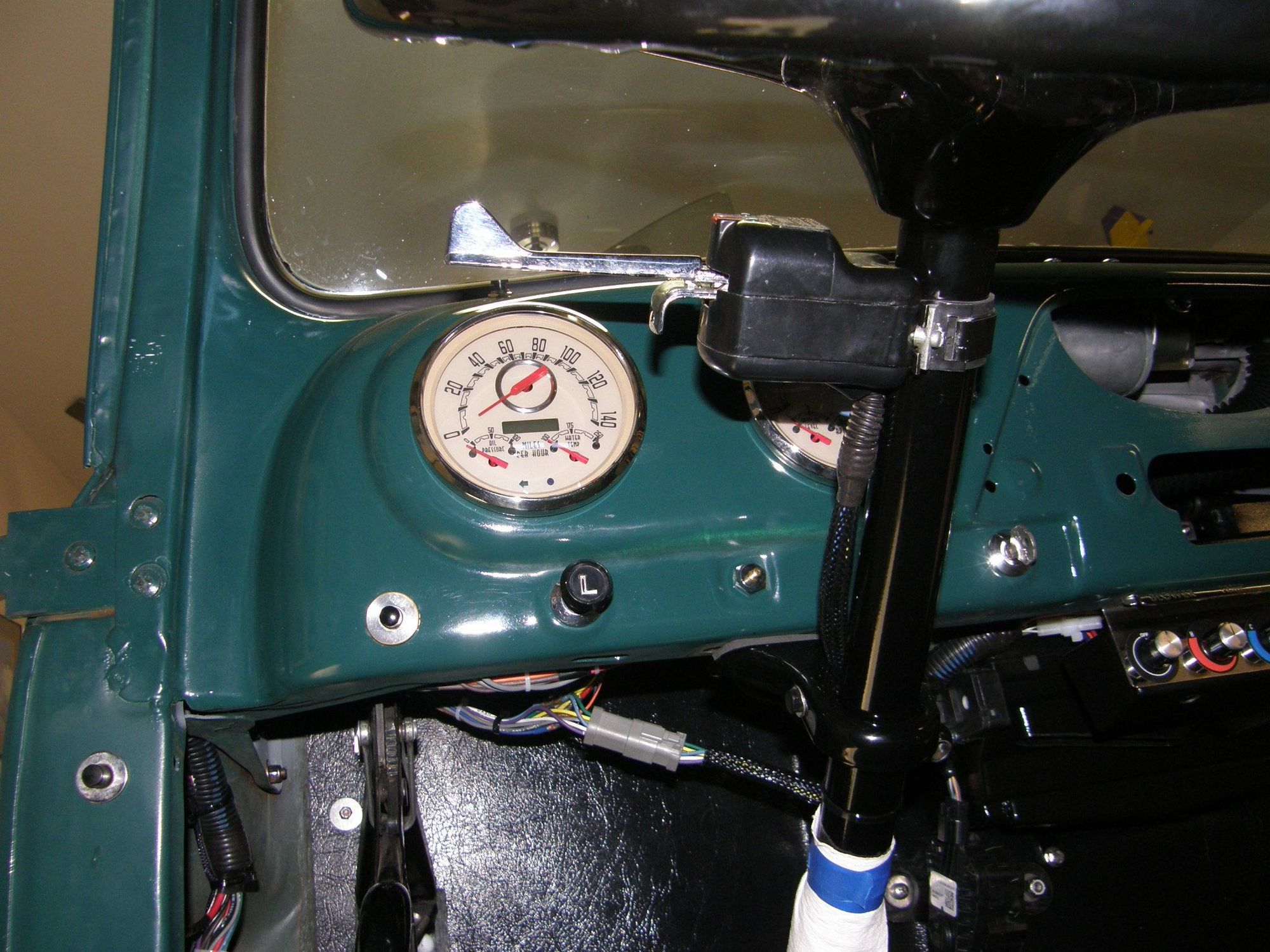

Has anyone ever installed a custom switch, like say a toggle switch for the wipers instead of the big bulky switch that would come with the mid fifty switch?

I did some searching since I posted this (my phone's almost dead)
As long as the motor has an internal park switch I can wire it to a toggle with a relay. Should be easy enough
You don't say for what year truck but did on the wife's 52. Used a pull type marine switch.
Switch is in the stock choke hole just to the left of the column.
Ordered a new **** with no letter and threaded it to fit the switch. Can't tell anything has changed and you just pull for wipers

No , but i will be soon, at least you have electrics on your vehicle(what yr?) mines a 50 f68 and vacuum wipers, hope my 6 volts can handle it. Cheers gary wait a minute, just saw your pics, looks like you might have had vacuum too, ill be watching your post
