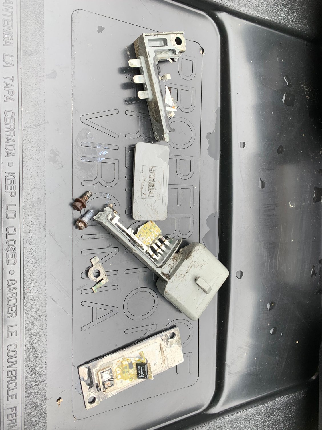

The never ending saga..,
Some sadistic mf’er who’s a previous owner tweaked this ignition control module on with a stripped bolt head...my new removal tool just spun around.
So, here is what happens...
God bless the mini Dremel tool...
Now, I search for a replacement bolt to swap out for the mangled one.
The casualty...
and all this...for that minuscule little bolt...

It was too late by the time i read this...I had mangled the old module beyond use or repair...good riddance.
