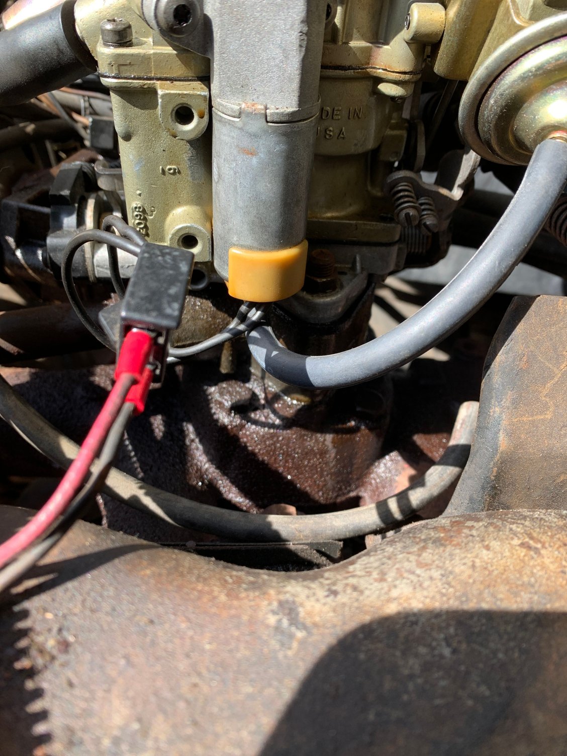

On youtube it seems like some models carburetors have access holes where you can manually pour some fuel directly into the bowl for the float.
Mine clearly does not have that.
Will pouring a few shots of fuel down the main carb-hole (where my butterfly valve is) achieve the same results...eventually?
my "main carb hole"

That brass tube cut at an angle. Put it there.
Yep that's the bowl vent to the motor side.
There might be one on the front side, kind of looks like a fuel line would hook to it.
That is the bowl vent to the charcoal canisters under the battery.
Dave ----

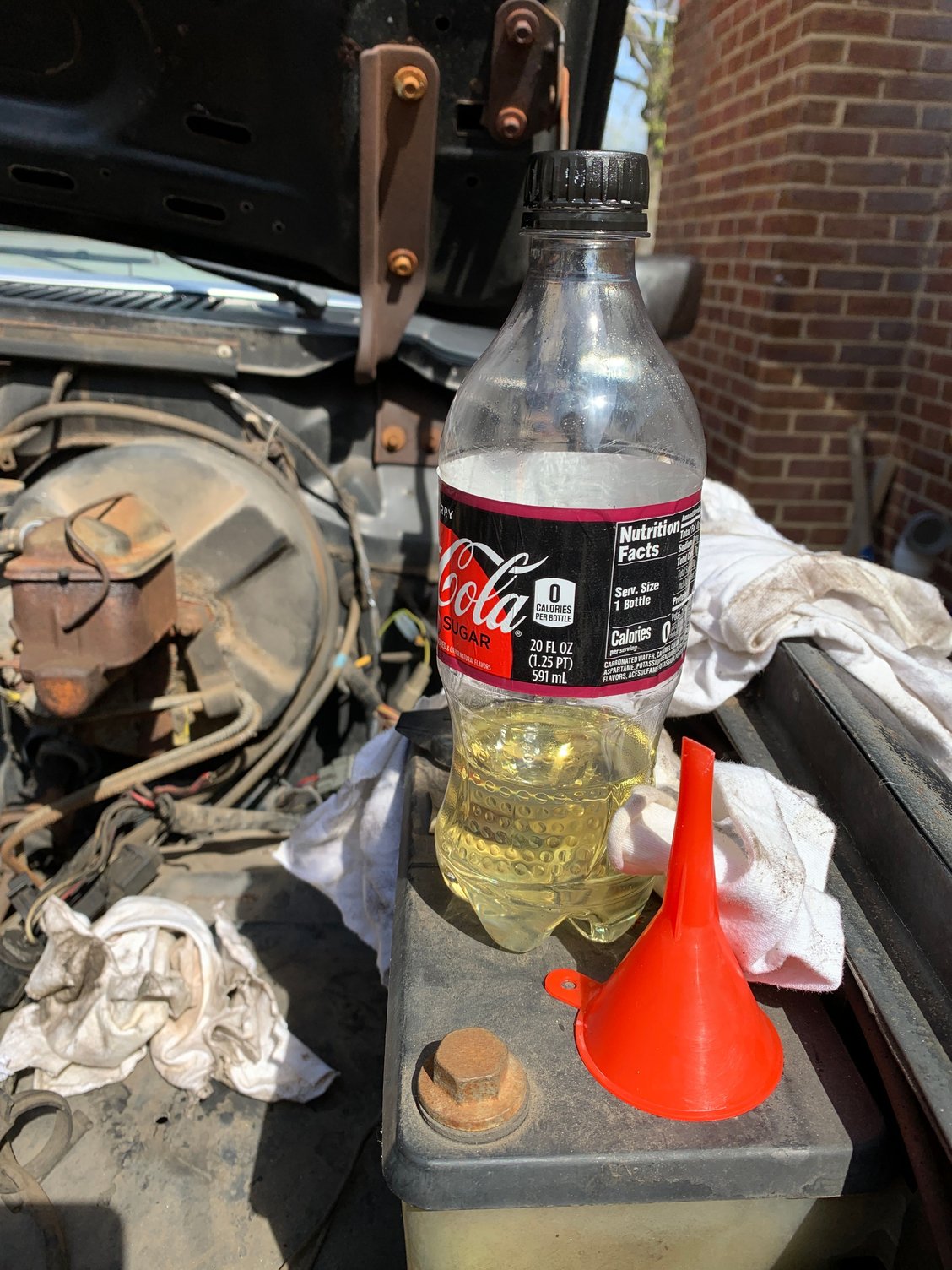

Used an old coke bottle and a mini funnel.
Fuel immediately started leaking around the base of the carb...
Um, this grabbed my attention right away. Something doesn't sound right with fuel appearing immediately at the base of the carb.
Did you spill some fuel externally and that's where it collected?
Or did the fuel come from inside the carb somehow, such as from a cracked casting or a loose fitting?
