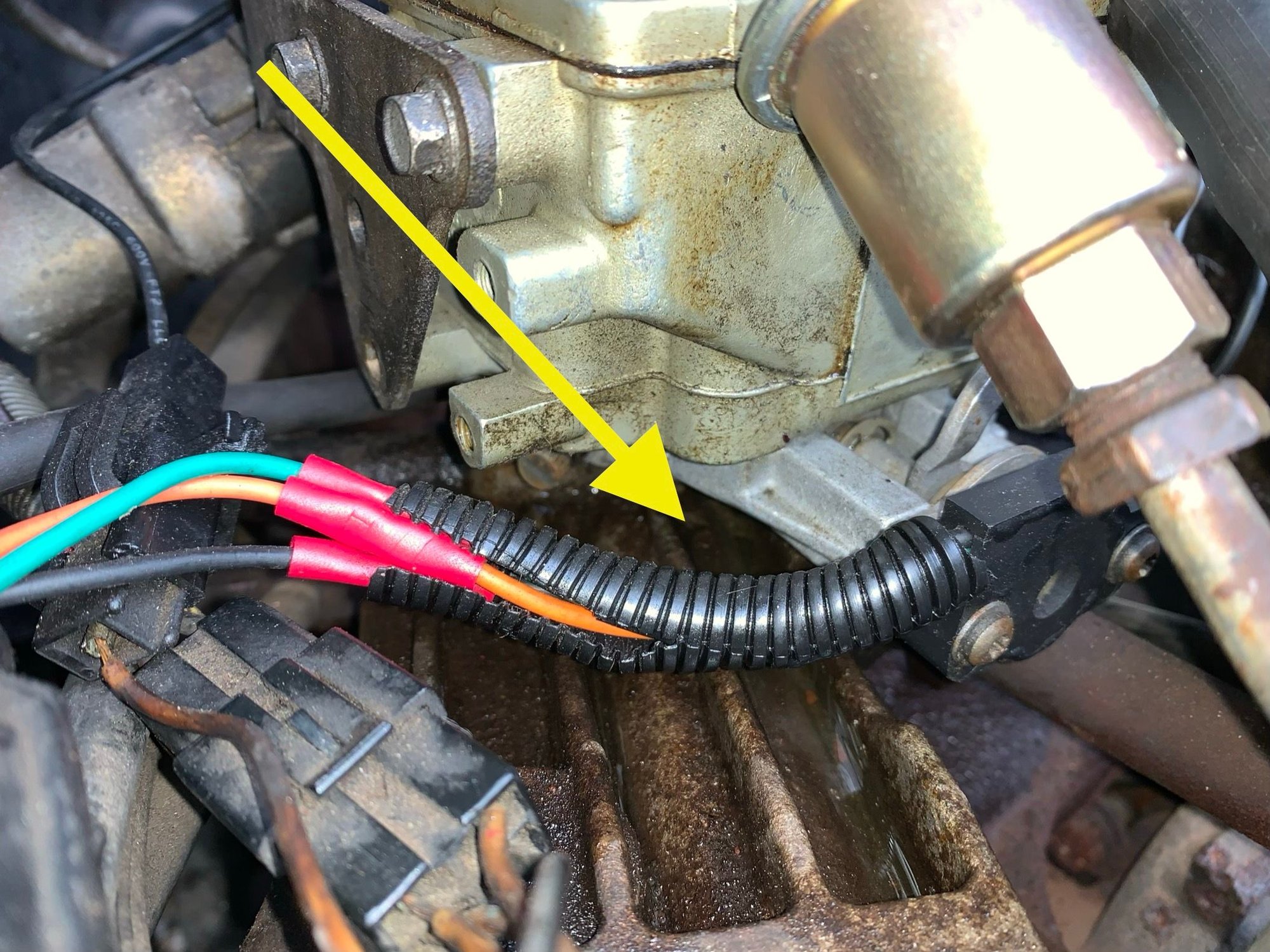

The leak...
As far as I can tell, the carb’s fuel leak seems to be coming from an area under the gasket which I suspected. Sort of where (in the photos below) the bronze metal meets the lower silver metal area.
So possibly below the gasket that I initially thought was leaking.
Anyone know how these two parts come together?
From the passenger side front area of the lower carb.
From the passenger side front area of the lower part of the carb.
From the passenger side fender area of the lower part of the carb.

Between the base of the carb and the carb base plate adapter? There's a gasket there. If you are talking just above that, at the joint between the throttle body and the main body of the carburetor, there's a gasket for that too, comes in a rebuild kit.

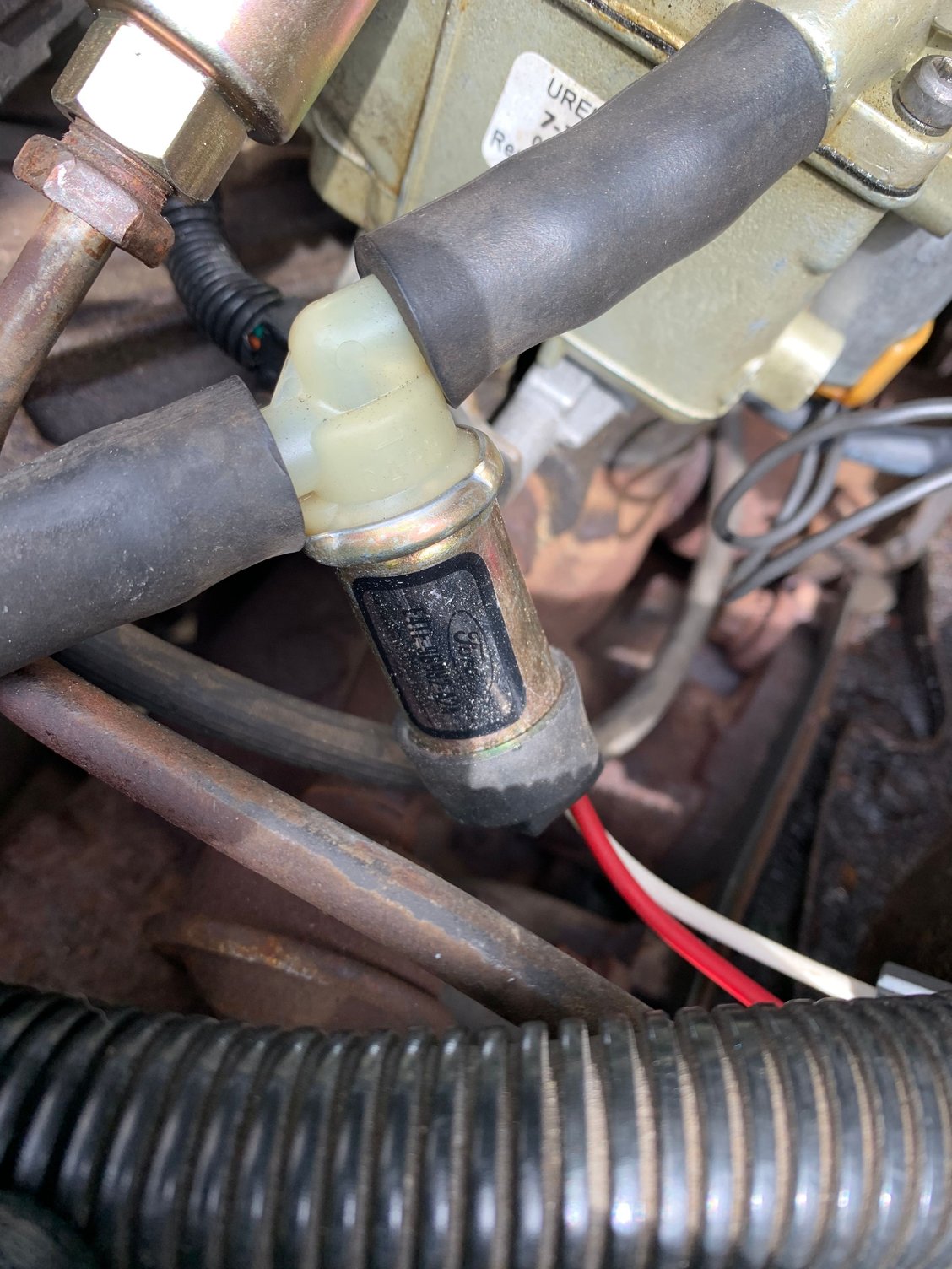

One other possible factor...
I recently noticed that the below broke in half, so I ordered one off of eBay and replaced it...fuel bowl vent solenoid?
Anyone know how to test this baby and confirm that it’s working? IF it wasn't working correctly, would this contribute to my hard-starting issues?

If it is broken it should not keep the motor from starting or running.

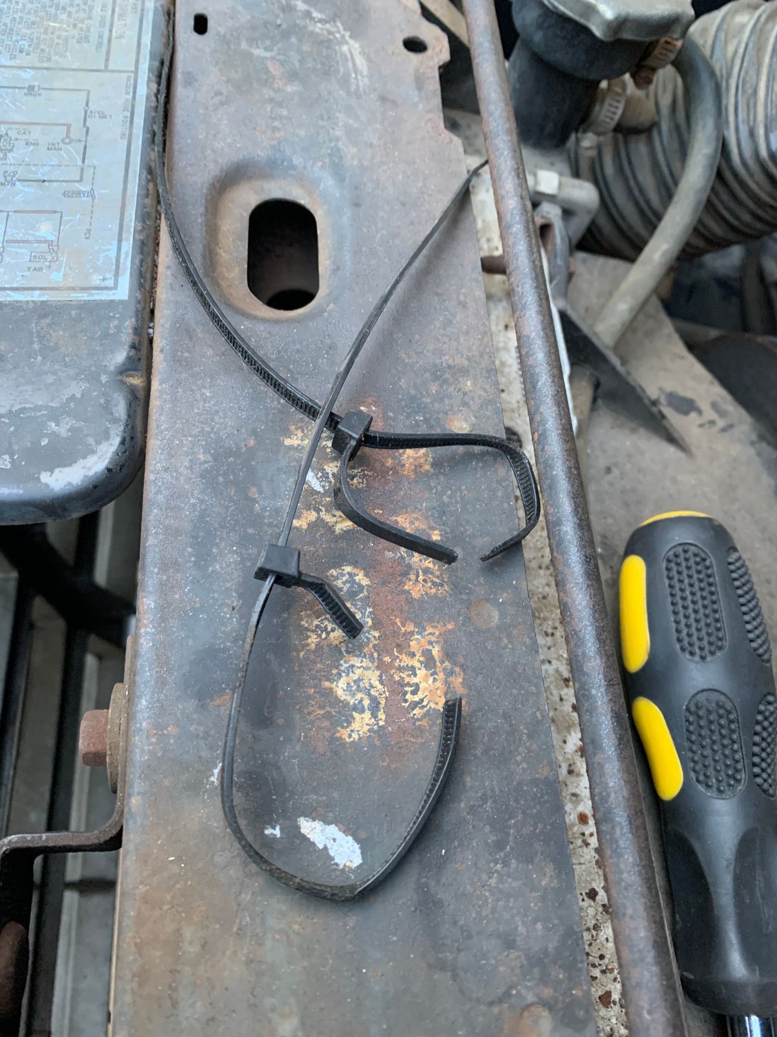

it feels like a little bit of progress...which is encouraging.
here are a few updated photos...
The drivers side fender. Did a previous owner remove the ignition control module from over here? Do I NEED one over here?
Any idea what kind of bolts hold this ignition control module to the side of the distributor?
These were zip ties that were holding the ICM wiring harness inside the housing...i mean, seriously?!?
