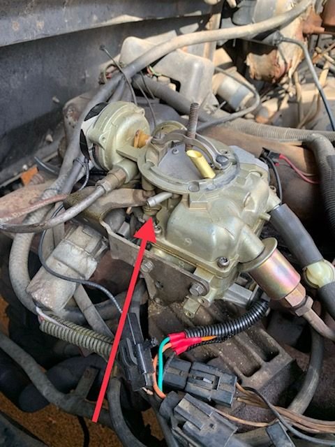

Cold air intake for the climatic choke. Tube, connected with a short piece of hose, runs from there down to the exhaust manifold. Then the one to the left of it in the picture runs up and attaches to the choke, supplying air heated by the exhaust manifold.

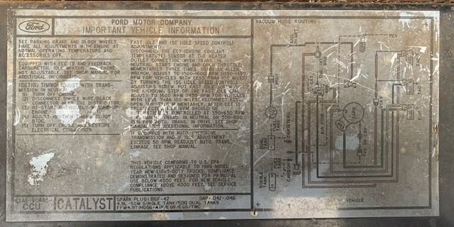

Post a picture of your routing sticker on the radiator support.

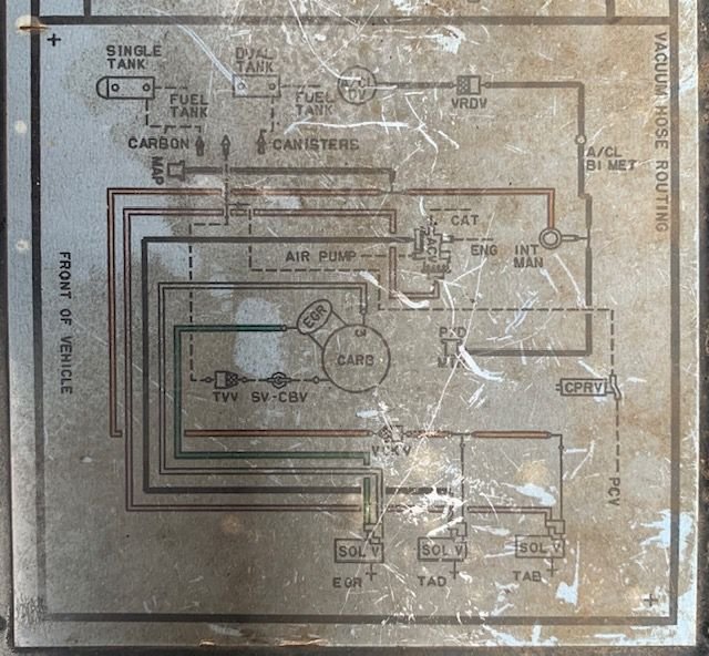

The choke piping is not shown in the vacuum diagram above.

Nope, never is. So, can't see your air cleaner, I figure that loose line connects to it somewhere.

If the other end of that line goes to manifold vacuum, then it probably does go to the temp sensor in the aircleaner. The sensor is called "A/C BI MET in the diagram

I just noticed something also. In that diagram the canister purge goes to the PCV valve connection. I kept thinking they did that on some models, but never could verify it. That is what that little nipple on the new PCV valves is for that you have to cut with pliers if you need it.

Second one is open on the Ford valves, which I think are the same as the GM. Runs through an external purge valve, or one built into the cap on the canister.

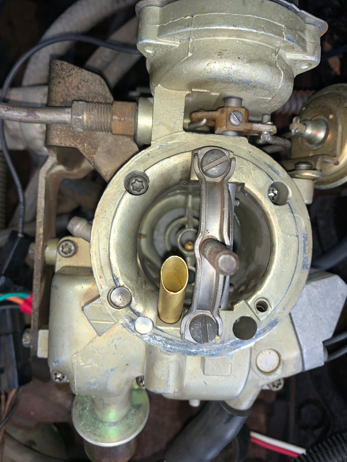

When you pull that choke door open, can you peak down in there and watch while you pump the throttle open by hand? Each time you do that you should get a strong stream of fuel going into the engine. If you do, that is just as good as the starter fluid. You can pump the gas a couple times and then see if it will fire off.
If you are not getting a good strong stream of fuel, there is something wrong with your accelerator pump in the carb. Or you do not have any fuel in the carb.
I just stood over the carb, opened up the butterfly and looked right into it. I then pushed the throttle...I saw 1 single meek little squirt. That’s it. Pushed the throttle multiple times. Nothing else came out.

Ok, that's a problem. Now to figure out what is causing it. When you finally get this thing started on starting fluid and warmed up, did it run ok or did it have a bad hesitation when you hit the gas pedal? I am trying to determine if your accelerator pump is bad, or you just do not have any fuel in the carburetor.
If it has a bad hesitation when you have been driving it, that is a clue the accelerator pump in the carb has a problem, and you have been getting puny dribbles all the time. And that is why you are having a hard time starting it, you can't squirt any fuel in there to help it get going.
If it has been driving fine when you finally get it going, then I suspect you do not have any fuel in the carb. I would pull the fuel line off the carb and put a rubber hose on it and point it in a bucket. Then crank the engine over, you should have strong spurts of fuel coming out of the hose when you crank the engine.
Mine is hooked up that way but I don't have any of the other things other than the bowl vent hooked to it.
I had a vacuum leak where I could not get the idle speed lowered and traced it back to the PVC & canister and bowl vent pulling too much vacuum.
My fix was to take the smallest carb jet from a Holley carb jet kit and install it in the hose. I wished I could have gone smaller but that is all I had but was then able to adjust the carb.
Because I did not have all the solenoids and other valves I did way with all the vacuum lines other than for the canister & carb bowl vent, vacuum advance on the dist., power brakes & vacuum supply to the HVAC system.
No other hoses in the engine bay. Mine is an 1981 F100 300 six & T18 trans.
Dave ----

Carb looks new to me? So why the kit?
