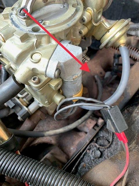

Before squirting some starter fluid into the carb, I noticed this random hose laying there under the carb. This is shot from the drivers side. Red Arrow points to the tip of the hose which wraps all the way around to the passenger side and should obviously be attached to something.

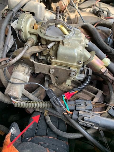

Here is a y-connector where that loose hose originates from. It's under the carb on the passenger side and wraps all the way around to almost the rear of the carb.
AND...while poking around looking for where my new lost hose attaches to I noticed this little guy just sitting out there...nothing attached to it. I DO NOT thing the hose I found attaches to this, because it's literally just above the y-connector. Is this something I should cap off? Anyone have any ideas what's up with this lonely guy?

In the picture below, that steel line there going to the side of the choke, does that go down to the exhaust manifold? I think it does and that mystery open nipple in the picture goes to the other end. That steel line sucks warm air from the exhaust manifold into the choke to open it up. It needs clean air for it's supply, it gets it from a hose attached to that nippled which leads to the inside of the air filter area where the air is filtered.

I'll give this a shot in about an hour.
Thanks,
J
