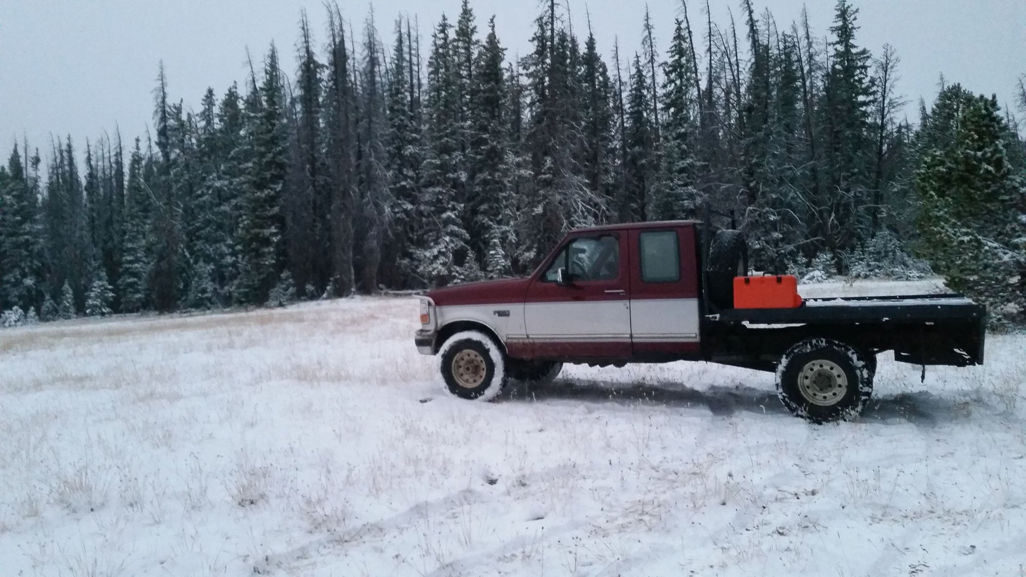

Those Moog springs are cheap. No way I'd do blocks. I used 844 springs, believe I paid under $70 shipped to my door. 1996 supercab shortbox, 351W/E4OD/4x4 with AC. To do it again I'd probably try the 824 set for a more compliant ride.
CC844 springs up front. About 2" lift in rear. 33x10.5 tires.
