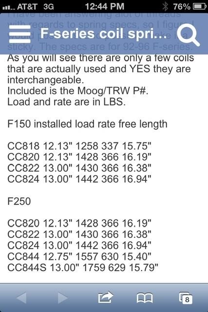

You are one nut away from removing the old spring. How much is the leveling spacer? If you are planning on replacing the spring in the near future then, IMO, you are wasting your time and money on the spacers. In addition, if you are going to take the truck for an alignment then you should take it back after changing the springs since it will be different than the spacers. That means paying for two instead of just once.
wrongway01 did not say what Moog coils he used. I believe I used 844 which raised the front end.

Added a spring chart to my post.
If the camber is too negative it will wear the inner part of the tires.
When aligning the TTB front end you measure what you have then see what adjustment is needed to get back into spec. There is a chart that says what eccentric to use to get there. The other option was to remove the current eccentric and replace it with a zero degree eccentric. Take measurements and then replace with the new part. Remeasure to make sure it is now at the desired setting. Last thing to do is set the toe.

Forgot to add, I used Moog CC820 front coils. They are progressive and I needed new coils anyway. I looked at the lift springs but I wasn't sure how they would ride. Stock rate springs ride good for me. When they aligned my truck I was told that the 3* degree wasn't quite enough on the right side and I only needed 1.5* on the left to set camber.
