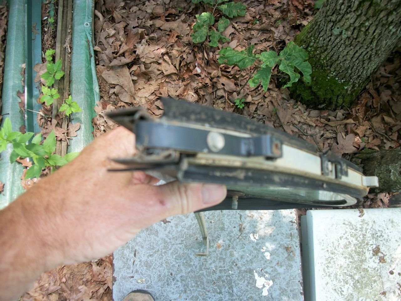

Completely different question. How do you get the vent window out of the frame?

Look at the angled front edge of the door 3 phillips head screws. Remove. One bolt (below the regulator) that holds the very bottom of the division bar in place. Remove. Angle the vent window (it will be one piece) and the glass and the long division bar. You might have to work out/wiggle around the bracket at the very bottom of the division bar to get it out between the door skins.

Trying to get the glass out of the frame. Already pulled the assembly.

Well it is held in with "glass setting tape". Here is a thread on removing and replacing the glass.
https://www.ford-trucks.com/forums/1...storation.html
In the above thread post #110 talks about removal and 115 and 132 about installation.

Heat gun will help,,I replaced mine , its not to bad and you can buy the glass tape needed for replacement
If you mean remove the vent window glass out of it’s frame, I just did that. I boiled water in a 7 quart Dutch oven and dipped the window and frame in until the adhesive softened enough for me to pry the glass out. I wore gloves to handle the hot window/frame.
