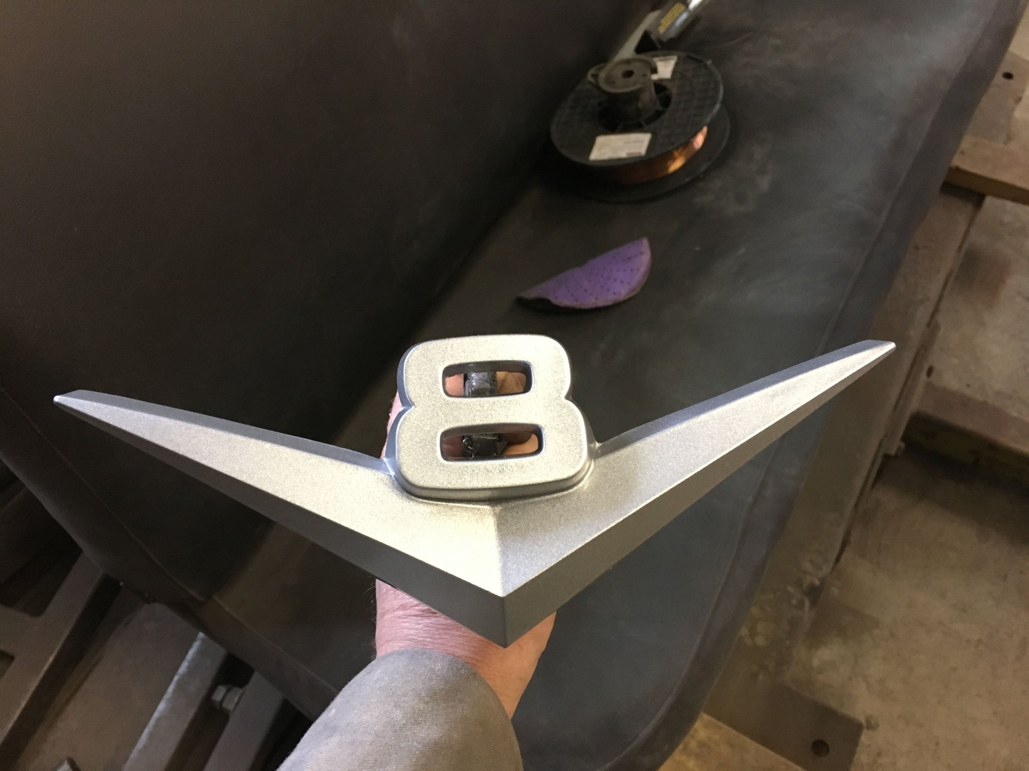

This is what I did with my grill badge because getting it rechromed was crazy money and I could have three repops for the price of chroming.

Is that a chrome look paint or just a bright silver ?
The emblem is painted in aluminum
paint. The link I posted shows the chrome paint result.

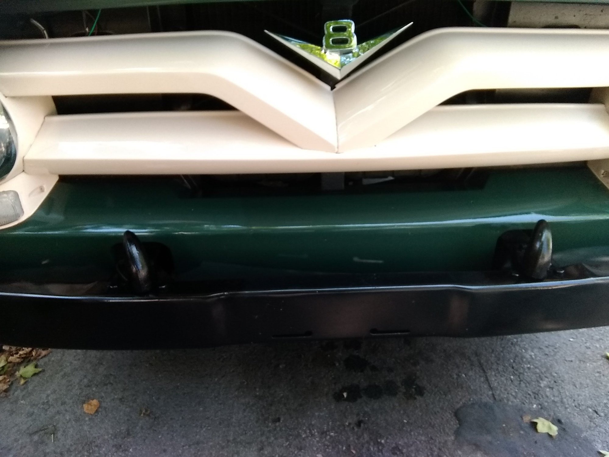

For those that have a 55 V-8, Carpenter's sells seconds the 55 V-8 grille emblem half price. I bought one for my 55. It looks great.

Abe, that emblem is crooked! I was trying like heck with my mouse pointer to nudge it to the left a little, but it wouldn't budge. Might want to straighten it before Wade's next calendar shoot.

Hmmm, I never noticed that... or maybe it's the angle of the camera. I'll check it out when I get my truck out of storage April 5. And with the progress I'm making with my shoulder, I'll be able to drive it home myself.
