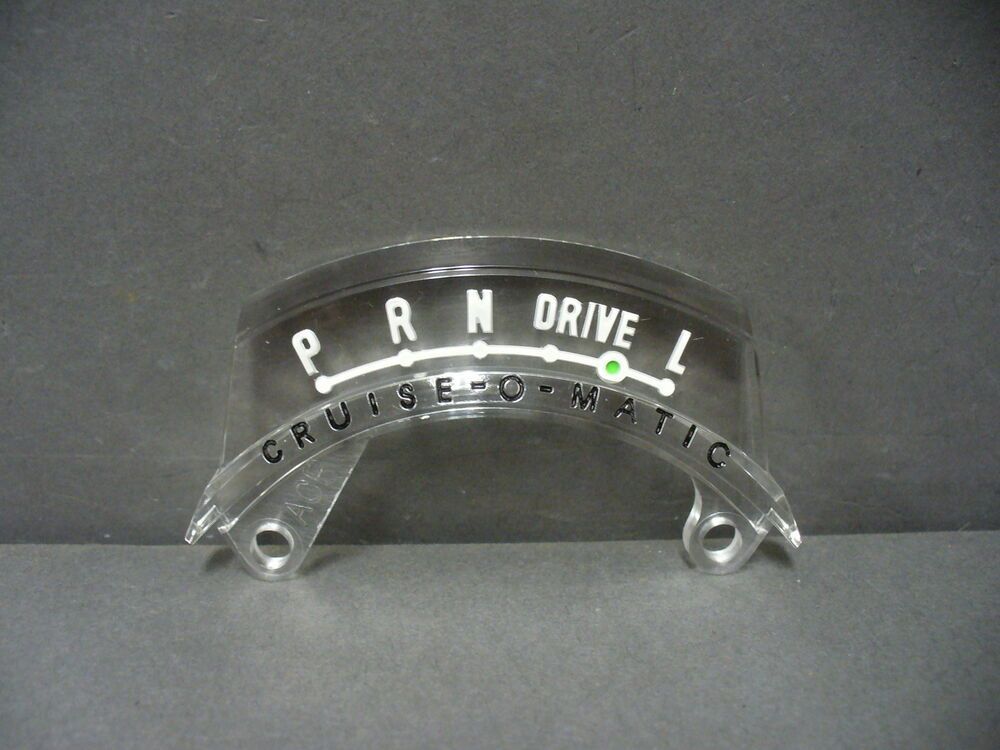

On a side note, was the 2 speed offered in F100's? Was thinking only cars. I only have two gears, but it does not seem to be starting in second, nor missing drive. There are only 2 detents as well for forward gears, but the shifter has a considerable amount of play in it. Goes into gear and shifts very well, was rebuilt in 88, has roughly 150k on it, speedometer died some years previously at 388000

Early Ford-o-Matic started in second. Do you have PRNDL for a shifter quadrant? If you start in L then shift to D do you get 2 shifts? Vs. 1 shift if you start in D?

The selector dial you show is for a DUAL-RANGE CRUISE-O-MATIC.
The GREEN DOT position will give you three forward speeds whereas the other position (WHITE DOT to left) will give you a 2nd second gear start. You need to ID the TRANS and condition of linkages.
EDIT -
The L on a 3S COM (as shown on the dial indicator you posted) is first gear only and is held in first gear until you move the shift lever.

Figured out the transmission too after some reading, apparently the cruisomatic only starts in first if you put it in low, where it shifts 1-2-3 perfectly.
