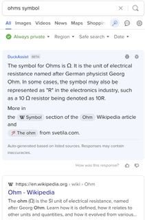

Ok so dumb question but i went cheap and bought the $6 harbor freight multimeter/voltmeter and 1.) I don't know how to use it hahaha and 2.) I YouTubed a video on how to use it and I'm questioning if it's so cheap that I'll never get the right readings on anything I'm looking for (I bought it because I also have phantom draw somewhere) so my question is what symbol is for ohms? Amps? And auto is direct current DC right? So what is DCV

that's the Ohm symbol. if the meter has that listed as one of the settings to go to. with the steering wheel controls pad off the truck and the
meter set to Ohms, put the red lead on the pin to test and the black ground to the metal center piece. The youtube video should show you
the expected values you should be looking for when you hit each of the buttons respectively.
as for DC/AC...when measuring voltage on the battery, use DC volts. black - neg, red - pos

That was easy enough to find out on your own. There are even instructions on how to use a DVOM if you ask AlGore’s amazing internet. Google, Bing or whatever is you friend
A is amps
Auto what? Auto scale so it automatically changes to the appropriate scale. I assume Ohms?
DCV —> D C Volts
I have a cheap DVOM I bought many years ago and it came with instructions. I can’t believe yours didn’t or there aren’t instructions for it online.
