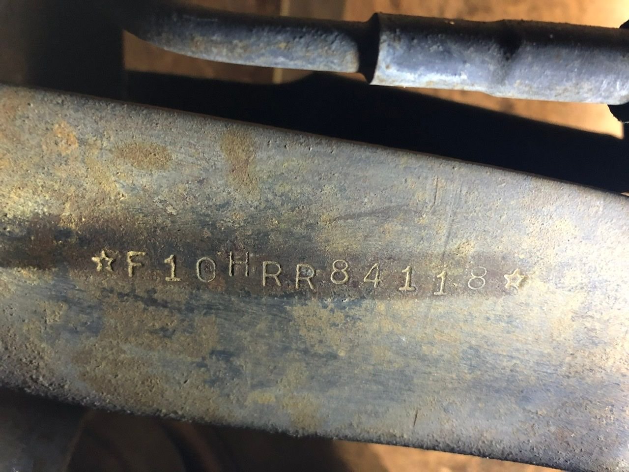

Hi guys,
I am in the process of registering my truck in Spain. Yesterday, the engineer was at home taking measures, etc.. and asked me for the VIN stamped in the frame rails. I said I don’t think there is such a number stamped there, but I will look for it. He also asked me for some numbers stamped in the engine, but again, and apart from the date code I found, I said I don’t think I could find any other number that relates the motor to the VIN. Do you guys know if there should be a number in the chassis/frames and in the engine I should know.? I am not confident I can find those numbers..
Thanks y’all,
Josep

No VIN on engine. Check out this thread for frame stamp location

Originally Posted by Josep66
Thanks Jason, that is also valid for 1973 trucks.?
Yes that's valid on 73s as well. And you will find no such VIN stamped on the engine

I went out and tried to locate the VIN in the frame rail as explained in the link you gave.....I found it.!! So happy.!!

For future reference:
F10HRR84118
F10= F100 two wheel drive
H= 390 cu in V8 engine w/ 2bbl carburetor
R= San Jose (California) assembly plant
R84118= 1973 Truck sequence number (1973 numbers run from Q00,001 to S60,000)

And very glad too that your VIN numbers were stamped clearly! Many of them were very shallow and hard to see after so many years of dirt and rust and oil.
Yours were very clear and easy to read. Makes life much easier when registering.
