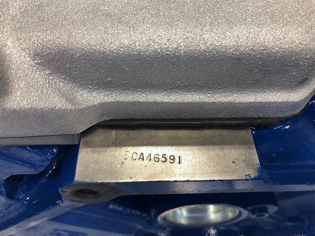

I feel like the date code was cast as well, but I wont know until I clean the paint off that portion. There is also, passenger bottom towards front of block, a machined flat with two sets of numbers stamped or engraved, first is 4-digit, second is 6 digit. And I haven't been able to find anything on those.

Some engines, for example, have part of the VIN stamped into the block. The 302 in my 1984 has the last 8 digits of the VIN stamped in the block, just behind the intake manifold (Close to the firewall). I've done some reading on this and it seems Ford was not consistent with this stuff...some engines were stamped, and some were not. I'm taking the 302 out of my 85 this weekend and plan to check and see if by chance it was stamped as well.

Have not come across any VIN's on the engine yet, but who knows? Going to clean the rest of the grease off of it today, think I'll turn my phone off just to be sure.
