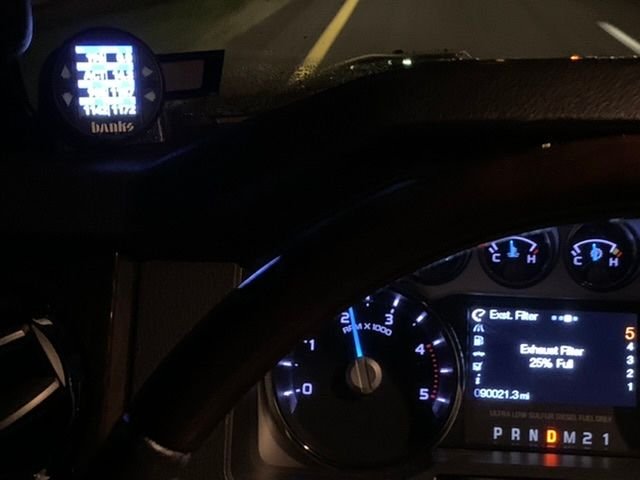

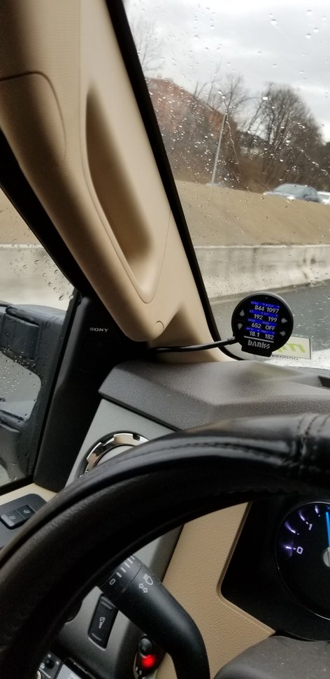

Do you have another way to monitor your DPF soot load? I’m assuming that you’re going off of the enabled ghost screen DPF % meter. I can tell you that the actual soot load and the % meter have quite a variation between the two. I hit DPF full the night before last. My soot load meter on my Banks Derringer iDash showed 119%. I set my cruise control at 75 mph and drove to let it do it’s thing. My DPF is only 6 months old btw. When my ghost screen showed 70%, my actual soot load was already at 31.2%. At 65%, it was down to 27.9%. At 50%, it was down to 13.7%. At 25%, it was down to 0.0%. That was when my regen went from Active to Off. By the time I got home, the ghost screen showed 15%. It did this all in 22 miles, running 75 mph. Without a monitor of some sort...you have no way of knowing when your regen kicks off.
The pictures below show my Derringer. These are my parameter readings that I set up to monitor:
1. Engine Coolant Temp 2. DPF soot load %
3. Regen On/Off Status. 4. Battery Voltage
5. EGT 1/1 6. EGT 1/2
7. EGT 1/3 8. EGT 1/4
EGT 1/X = Exhaust Gas Temperature sensors # ​​1-4
I like to monitor my EGT sensors in case one of them goes bad. A bad sensor will leave you stranded on the side of the highway. Thanks EPA! If you had a way to monitor them, you probably would’ve known if your P24A0 code was related to a bad sensor.
70% showing on ghost screen
Regen now Off
Ghost Screen still depleting 5 minutes after regen kicked off.
