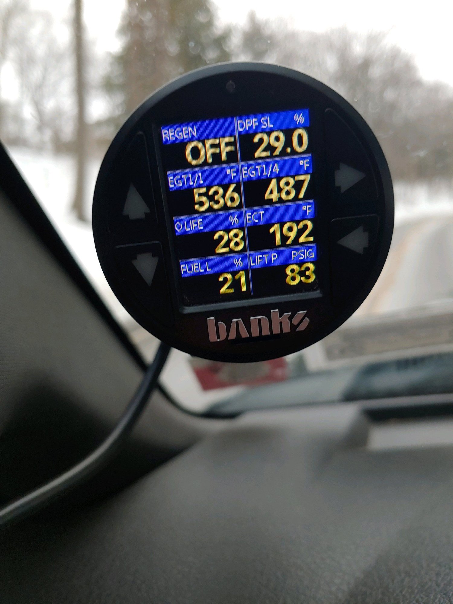

About passive regen temps, this was from yesterday:
It was at 31.2% when I got on to the expressway. Passively regened to 30.7%.
Reduced down to 30.1%.
Reduced to 29.6% still on expressway.
Off expressway, climbing a hill. It ended back up at 30.1% when I got home.
I don't know if the K100 helps with that or what, but those are the EGT temps I see passive regeneration at.

From: SoCal/Wyoming
I have an iDash 1.8 and it has the newest version of firmware (V1.18.2) but it does not have the option of selecting DPF Soot Load Percent (DPF SL). I only have the option for DPF Regen Trigger percentage (DPF RG). Is there a difference between these two?
Old Jan 28, 2020 | 06:55 PM
  #40
jav_eee's Avatar
jav_eee
Joined: May 2017
Posts: 969
Likes: 30
Originally Posted by SARDiverDan
I have an iDash 1.8 and it has the newest version of firmware (V1.18.2) but it does not have the option of selecting DPF Soot Load Percent (SDP SL). I only have the option for DPF Regen Trigger percentage (DPR RG). Is there a difference between these two?
Yes, the trigger is a "countdown" (or up) to when a regen will be commanded by the truck. I need to update to see if the SL% is there.

I would think it is still an option under emissions for the soot%

That's odd. I'm running version V1.18.1 and I have it. The ignition does have to be running in order to reach the correct page FYI. Make sure the tuner is asleep, start your engine, then navigate where you need to go. I hit the right arrow to enter the menu, followed by gauge selection, then whichever field you want it displayed in, category, emissions, then scroll down to DPF Soot Load %.

I just installed mine today and there is no option to select DPF SL. I screwed up that last post, no idea where I came up with SDP SL or DPR RG. One of those days I guess...

Maybe 18.1 has it but not 18.2 My only DPF choices are Regen Status and Regen Trigger
Like dirt said, I have 1.18.1 also. I checked the website. It's the latest version.
